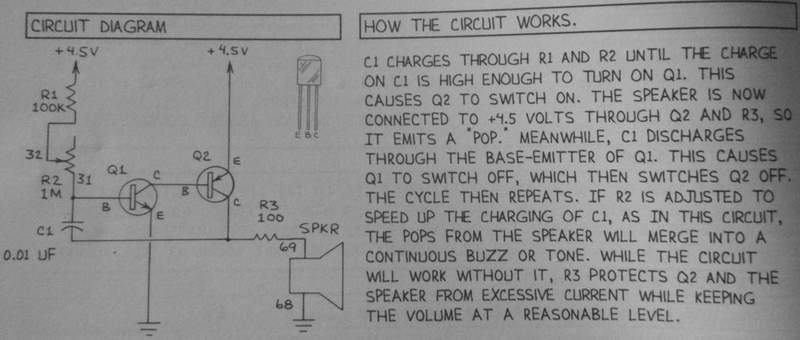

How does this circuit *really* work: 2 transistor metronome
In summary, the metronome circuit found in Radio Shack's "Getting Started in Electronics" book is a popular one on the internet. The circuit includes two transistors and uses positive feedback to ensure fast switching and efficient power dissipation. The purpose of the second transistor is to allow for independent voltage changes on each end of the capacitor, allowing for quick charging and discharging. This circuit can be simulated and modeled using Falstad's circuit designer and has been explained in detail on various online forums.
rp55
82
I have some questions about this metronome (clicker) circuit found in Radio Shack's "Getting Started in Electronics" book. This circuit seems to be a popular one out on the internet(s) as far as metronome circuits go.
Circuit: http://imgur.com/XyTasy3
The other night I said to myself if I can't understand this circuit completely I shouldn't bother trying any further with electronics (given all my studying thus far). So here we are...
Here's what I've done so far...
I have successfully created the circuit on a breadboard. It works (and sounds) like a metronome adjustable via either the cap size or the pot.
I get this on my scope by probing S (probe is grounded to battery negative):
http://imgur.com/tRkuKDd (this is not actual.. i found this pic on internets but it's close... less frequent "hits"
If I zoom in a lot, I see a nice waveform like this:
http://imgur.com/Gi0g7te (that seems nice... like a nice gentle speaker friendly waveform)
I have also somewhat (I think) successfully modeled/simulated it using Falstad's circuit designer:
https://tinyurl.com/lnu7tas
although the output on the virtual scope doesn't look like my real scope... and also, the only way I could get the cap to show discharged current flow was to get it to where it sometimes gives a convergence error...

One big question I have is why are 2 transistors necessary. Why couldn't Q1 be used alone. Apparently the whole C1 acting like a short circuit thing doesn't seem to happen without. I have no idea why.
Also, I get really confused about which way the speaker cone is going (is it pushing out or pulling in) at whatever times. At one point it seemed as though the speaker would always be pushed out whenever the transistors were working but I didn't see any dc offset on the real scope.
I do believe that the reason C1 wants to discharge is because of the current flowing out of Q1. I'm not sure exactly how, but I'm thinking it negates somehow the stored field in C1?
I did learn by watching a recent youtube video on electronics that I may have TBS (Teflon Brain Syndrome). Something's not sticking with this stuff! :)
You can make this type of oscillator with only one transistor. The "legitimate" way to do it uses a unijunction transistor instead of a conventional type. See http://hyperphysics.phy-astr.gsu.edu/hbase/electronic/relaxo.html
But you can get away with some common standard (BJT) transistors if you abuse them by running them outside of the conditions they were designed for. (in fact, the transistor base is not connected to anything!) The output is too low to drive a speaker at a reasonable volume, but the lower current needed to flash an LED works. You could use a second transistor as an amplifier to drive the speaker, but your circuit already does that. See the bottom of this page: http://members.shaw.ca/roma/twenty-three.html
The basic reason why you need 2 transistors in the circuit you showed, is so the voltage on each end of the capacitor can change independently, to charge it first one way and then the other. With only one transistor, you don't have enough options available to do that.

The purpose of using 2 transistors in this arrangement is that it gives fast switching. The main current-carrying transistor, Q2, spends almost its whole time either fully on or fully off, with minmal time transitioning between those states. It is the intermediate state, where Q2 is neither fully on nor fully off where its power dissipation (meaning wasted power) is worst. By using positive fedback to ensure the switching is rapid, we create a circuit which is both fast and efficient, and Q2 can handle heavy currents bcause it is either off or in saturation, the states which cause it to dissipate minimal heat.

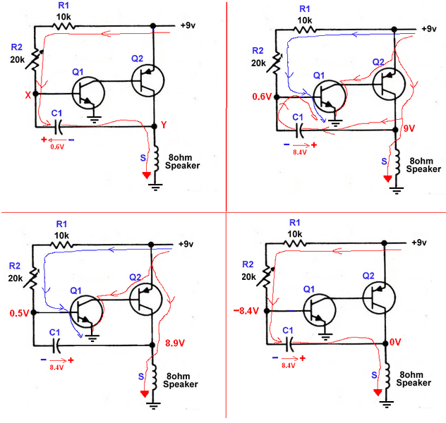

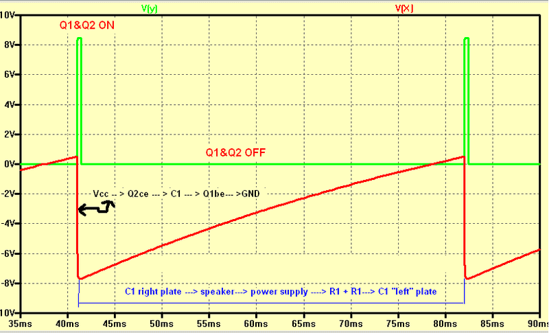

When we first connect this circuit into supply. The C1 capacitor is initial discharge.
So the voltage across capacitor is 0V (capacitor act just like a short circuit).
Immediately after we power up the circuit. The current start to flow via R1 and R2 resistor. But because C1 capacitor is discharge (0V across capacitor) all this current will flow through C1 and speaker to ground. No current will flow into Q1 base and this is why Q1 and Q2 or OFF.
But as you know voltage at charging capacitor start to rising. And when this voltage at pin X reach Q1 threshold voltage (about 0.6V) Q1 start to conduct a current. If Q1 start to conduct the Q2 all so immediately will start conduct current. This means the voltage on Q2 collector starts to rise (at point Y). And this rise in Y voltage is feedback to point X via capacitor C1.
But as you know the voltage at Q1 base (point X) can not be higher then 0.7V because of the diode in the base-emitter junction Q1. This means that there will be a huge Q1 base current. Which will ensure that Q2 is in saturation region, and the voltage at point Y is close to 9V.
Also at the same time C1 will quickly discharge C1 and then C1 will start recharged phase in the opposite polarity. All this will happens very quickly because of a large Q1 base current (charging current). Also at this phase the spearer "gives" a shot pulse of sound.
The C1 was rapidly charged to V_C1 = Vcc - Vbe - Vce(sat) ≈ 8.6V So cap no longer conducts any current. So when C1 capacitor is full charged. The Q1 base current is provided only by R1 + R2 resistor. R1 + R2 don't provide enough base current on Q1 to keep Q2 in saturation region.
So Q2 immediately after C1 is full charged comes out from saturation to the linear region.
So voltage at Q2 collector is start to fall. And this drop in Y voltage again is feedback via C1.
For example if voltage at point Y drops to 8.9V the voltage at Q1 base will also drop to 8.8-8.4V = 0.5V thanks to the positive feedback provided by C1 capacitor.
So eventually C1 that was previously charged to 8.4V "pulls-down" the voltage on the Q1 below ground (-8.4V). So Q1 and Q2 will immediately goes into cut-off.
And now C1 cap will act very similarity to a voltage source and start the discharge phase in the circuit:
C1 right plate ---> speaker---> power supply ----> R1 + R1---> C1 "left" plate.
Eventually cap will be full discharge (0V across the cap) but the current will still flow in the same direction and capacitor will start the charging phase, but I described this at the beginning.
So the cap will charge to 0.6V ( left plate more positive than the right plate) and Turn ON Q1 and Q2 . Also notice that in this phase the speaker current is to small to produce any "loud sound" on the speaker.
That is one complete cycle.
So as you can see Q1 and Q2 are ON for the "very short" time ( C1 charging phase).
And they are OFF for "long time" (C1 discharging phase). And the speaker play the sound only when Q1 and Q2 are ON.

Thanks for the response Jony130!
Right, got it.
Oh I see. I think I was missing that. I understood Q2 was in saturation region, but it didn't dawn on me that since it was pretty much a closed circuit thru Q2 ce (limited only by the "saturated" --wrong term likely-- inductor coil) so this starves Q1 base of current via the resistors. Is that right? I understand the Q1 be voltage drop is .7v. But the voltage at Q1 base is based on resistor values, no?
So the "discharge" is somewhat artificial since it is being "forced" to discharge via the Q2 collector current?? It's not just discharging because of negativity potential available on its left circuit side (Q1 base etc)?
Also, notice in your (very helpful) diagrams, the speaker is always pushed out, never back. When is it retracted to move air?
Aren't we assuming here that the cap had time to reach dc blocking state before Q2 started giving it counter charge on its right which it currently is in the state we are talking about here (Q2 is providing feedback via C1)?? How do we know it is fully charged from left for sure? Assuming it is not fully charged from left and still charging, it could never fully charge from left now that it is getting feedback from the right? I would think as long as it is getting feedback it could never fully charge from the left. But it probably doesn't matter. Now it will get charged from the right until fully charged...
You mean fully charged now from the right via Q2, yes? That makes sense.
C1 may still be being charged from the left AND from the right, no? And at some point C1 will equal 0v again (because of that charging via both sides), no? Eventually it will cross over from positive charge to negative charge (however you want to look at it)? That 0v deal makes special things happen (like the initial starting of the system).
But Q2 ce is no longer saturated and no longer near 9v. So plenty of current available now thru resistors to keep Q1 base on now, no? I'd like to understand why Q1 isn't forward biased now via the resistors. What is starving Q1 base here?
Jony130 said:
And now C1 cap will act very similarly to a voltage source and start the discharge phase in the circuit:
Notice how that speaker has never yet retracted?? It's always being pushed out. I guess at this point the transistors have stopped and that starves the speaker of current which withdraws it to 0v (but never negative?).

Well I thought I understood this circuit and posted a big explanation of how I understood it but now I'm stll unsure... what a mind screw this thing is.
rp55 said:
Jony130 View Post
Yes resistors don't provide enough Q1 base current to keep Q2 in saturation.
And this additional current is provided by the cap, when cap is charging from right to left.
From Vcc --> Q2 emitter-collector ---> C1 ---> Q1 base-emitter junction --->GND
And this charging current is very large because we almost short Q1 base to Vcc via C1 cap. And cap will charge very quickly.
When Q1 is in active region Vbe voltage is determined by base current.
As I said cap has already been charged to 0.6V, the positive voltage at Q1 base.
And so as Q1 and Q2 start to conduct the current. Voltage at Q2 collector start to rise.
So the voltage at right capacitor plate also start rising. And this is why C1 cap start "discharging" phase.
Because of the voltage change across capacitor plates. So the voltage on C1 will drop from 0.6V to 0V( end of discharging phase) but the current will continue to flow in the same direction because capacitor voltage is 0V but circuit want 9V at point Y and 0.6 at point X. So we have a potential difference and this is why current will flow and charging up the cap in the opposite polarity (from right to left).
Only when Q1 and Q2 are ON (in saturation) the IcQ2 current is large enough to push the coil.
Yes
Jony130 View Post
Just before this cap was rapidly charged from right to left. Because at point Y we have 9V and at point X we have 0.6V (Vbe voltage drop). So once the voltage at the terminals of the cap is equal to VY - VX = 8.4V the capacitor is fully charged and the current stops flowing through the cap, the charging phase is over. At the same time Q1 base current drop because cap no longer provide any current to Q1 base. And now the base current is to small to sustain Q2 in saturation. And this mean that voltage at point Y start to drop. From 9V to say about 8.9V. And now the magic of a positive feedback comes to play. The situation look like this:
Cap has been previously charged to the voltage around 8.4V. This voltage on C1 capacitor cannot suddenly change (charged capacitor act as a voltage source), so when the voltage on point Y start to drops, this voltage drops because C1 stop provide additional base current needed to sustain Q2 in saturation, the "left" plate of C1 decrease the voltage at point X (pulls down the voltage). And this drop in X voltage is equal to VX = VY = Vcpa = 8.9V - 8.4V = 0.5V decreases Vbe and base current even further.
And this will cause that the voltage at point Y will drop even faster. And this drop will immediately be feedback via C1 and this will cause X voltage to drop even more faster. For example
For VY = 8.9 we have VX = 0.5V and this will drop VY to 8.88V and VX voltage to 0.48V.
So the base current provide by R1 and R2 also must decrease his value because transistor will be almost completely OFF for for such a low Vbe voltage. At the same time this current (R1 and R2) cannot flow through capacitor why? The answer is very simple. How can current flow from lower potential to the higher potential ? At point X we have 0.48V and at pot Y we have 8.88V. And this is why this resistors current can not flow through the cap. At the same time Q1 transistor also enter cut-off so this resistive current must drop to 0A.
As you can see we have a very strong positive feedback via C1 cap in this circuit.
So as voltage at pint Y start to drop the C1 cap (previously charged to 8.4V) pulls down voltage at point X. And the smaller to voltage at point X the large drop in VY voltage. And this drop in VY voltage pulls down the voltage at point X even further. So eventually Q1 and Q2 will cut-off completely and this will force VY voltage to drop to 0V and cap will force (pulls down) X voltage below gnd. Now VX is equal to VX = -8.4V. I hope you see this "positive feedback" action.
And now the current through R1+R2 can flow. Because we have 9V at the Vcc, -8.4V at point X and 0V at point Y. And now C1 cap will act very similarly to a voltage source and start very slowly the discharge phase in the circuit:
Eventually cap will be fully discharge (0V across the cap) but the current will still flow in the same direction because there is a potential difference across R1+R2, so the capacitor will start the charging phase in the opposite direction up to the point where voltage at point X reach 0.6V.
And to help you understand what is going on in the circuit I show you a simulation plot.
For VY and Vx voltage.

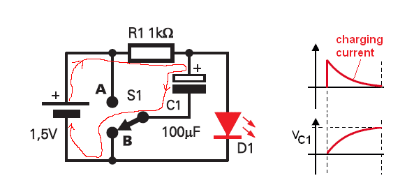

Right. I was confused about how capacitor works. They oppose a CHANGE in voltage, not oppose voltage the more they get charged (that's what I was thinking). Thanks for pointing that out! That should help me to understand better as that was throwing me off (and why you didn't understand what I wrote!).
At first glance you can treat capacitor as a some kind of a voltage source. The capacitor act very similarly to a voltage source. The key equation is this I = C*dV/dt
The capacitor current is proportional the rate of voltage change across it (proportional to how quickly the voltage across capacitor is changing). The faster the voltage change (frequency of a AC signal is high) the large the current flow through capacitor (short at high frequencies).
For example for this circuit
We have a switch in "B" position. So we apply a 1.5 volts to the circuit.
At the beginning of the charging phase the capacitor is empty, and so Vc1 = 0V
The voltage on capacitor cannot change suddenly form 0V to 1.5V. We need time to voltage on capacitor to grow (t≈5*R*C).
So immediately after we connect the supply voltage a current will begins to flow.
And all voltage from power supply appears across R1 resistor, VR1 = Vsupply. Because of a II Kirchhoff's law, 1.5V = Vc1 + VR1 and since Vc1 = 0V( empty capacitor) VR1 must be equal to 1.5V.
So we can say that empty capacitor act just like a short circuit because there is no voltage across it. As the capacitor begins to charge, the voltage across the capacitor begins to increase.
At the same time the current in the circuit begins to decrease. Why? Because the voltage across the capacitor begins to increase. So voltage across resistor must decrease (Vsupply = Vc1 + VR1).
And this is why charging current begins to decrease.
The capacitor eventually charges to the full voltage source potential. When this happens, all circuit current stops, because now Vc1 = 1.5V and VR1 = 0V If so no current can flow (Ohms law I = V/R = 0V/R = 0A).
And Vc1 in red show voltage across capacitor during the charging phase.
And VR1 in red show resistor voltage during the charging phase.
Can you describe what will happen in this circuit after we flip the switch into A position?
And can you tell me what is the voltage across the LED immediately after we flip the switch?

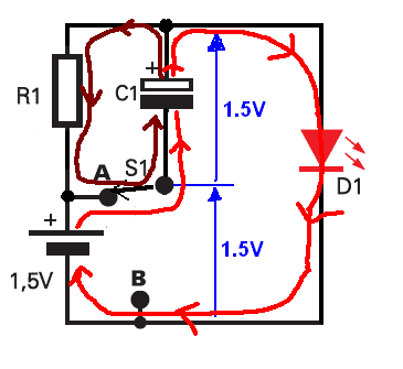

Basically it would cause the cap to discharge thru the led (due ?partially? to Vsupply) along with Vsupply powering the led thru R1. I guess I get a bit confused with parallel circuits still so that may throw a wrench into things also that I'm not seeing.
Then I think the cap would eventually fill again and block and the light would go out (assuming its forward bias is > 1.5v).
Well here's my guess: 2.5 volts.
Obviously Vsupply = VR1 + Vled.
First you would get the Vled.
Vled = Vsupply - VR1.
VR1 = Vsupply - Vled. If we assume the led voltage drop is 1v then VR1 drop would have to be .5V.
So the voltage across the led would be 1v (Vsupply - VR1) PLUS the capacitor voltage of 1.5 volts. So 2.5 volts? That's probably wrong lol but its my best attempt right now.
rp55 said:
Quote by Jony130 View Post
Right... 1/2 second in this case. So instead of time constant formula R*C (63% charge) you use 5 for full charge? Is that what you did there? I didn't know that, very useful.
Yes, capacitor is "fully" charged after a period of five time constant.
One question I have about your circuit though... doesn't the led start to light once the cap charges to .7v (forward bias or whatever it is 1-2v for the specific led) and then the cap stops charging at that voltage? Perhaps you were first talking about the cap charging as if the led wasn't there?
I use LED diode and the red LED has the lowest forward bias voltage around 1.5..1.6V.
So for sure LED won't start to light.
After thinking about it, you're probably implying that the led has a forward bias of > 1.5v ... so the cap fills before it ever lights. Then it lights when the switch is thrown via the extra cap voltage stored.
Exactly, you got this part right.
This diagram explain everything.
So immediately after we flip the switch the voltage across the LED is equal to 3V.
Exactly in the same time discharge current will start to flow. So the the voltage across to cap will start to drop. So the LED will blink.

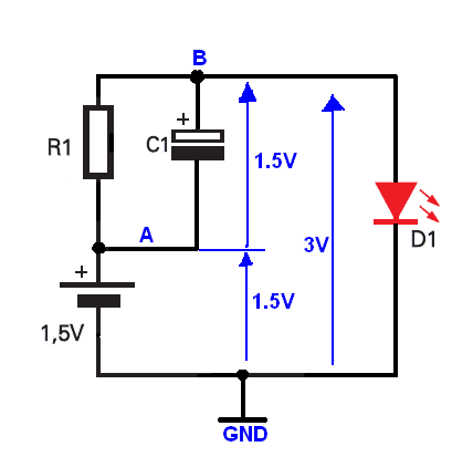

Why does the led get 3v then?
Why? Well because II Kirchhoff's law says so.
To measure the voltage we need two point in the space. One of this point is treat as a reference point (GND). We have a very similar situation when we try to measure a height of an object. We need a reference point. The most common reference point is "above mean sea level". But when you measure the height of your kitchen table in your house you pick the floor as a your reference point.
So for our circuit we have this situation.
As you can see I pick GND at the bottom as we usually do.
And now we can tell the voltage at point A and B with reference to gnd.
As you can see the voltage at point A is 1.5V higher then ground. And voltage at point B is 3V higher then ground. And the voltage across R1 is equal to VB - VA = 1.5V also notice that capacitor is also connect between this two point ( VC1 = VB - VA = 1.5V).
I hope that now you see why in parallel circuits the voltage is the same.
Also notice that diode is connect between point B and GND. And this is why Vdiode = VB - Vgnd = 3V - 0V = 3V.
