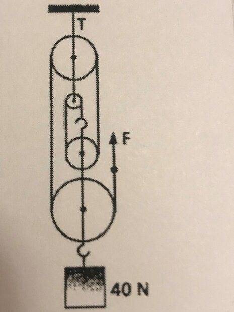

The masses of pulleys are negligible. What is the value of force F that keeps the block of weight 40 N in balance?
This system confuses me a lot. Our teacher just summed up all the tension forces of vertical strings, got 5F = 40, but can we really do that? If tension is the same everywhere, why isn't F = 40? Because all these strings aren't attached to the block itself I think. Could someone please explain how do systems like this actually work?
So apparently it is not. Can you see why ?
[edit] hint: a free body diagram for the bottom pulley wheel ? For the top one ?
Welcome @zuzelle !
The whole reason for using so many pulleys is to reduce the force needed to be applied at the end of the rope, which happens to be the value of the tension for any section of the going-around rope.
Just like it happens for a typical lever, that reduction of applied force is achieved by increasing the distance that the hand has to move respect to the distance the load moves upwards.
What you see in that diagram is basically a group of (rotating) levers simultaneously working.
Not exactly. Your teacher summed the five forces that the string wrapped around the pulleys exert on the lower pulley assembly. That excludes the string attached to the ceiling and the string attached to the weight.
Since it is all the same massless string, and can freely rotate the pulleys, the tension must be the same in each section.
