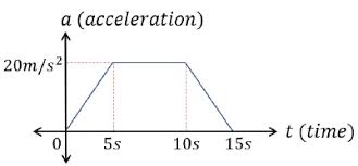

why would a constant acceleration be a parabola the slope doesn't change
I think one graph a-t would be the one I should do
here is sample from another problem from google images
The speed of $2\text{ m/s}$ seems rather low for a car — it's a walking speed.

yeah I think it should be 20 not 2
the copy was really hard to read...
that would make the horizontal lite blue line to 8+3=11s
wow thanks for the graph
ok I did this fot a-t and 20 m/s
