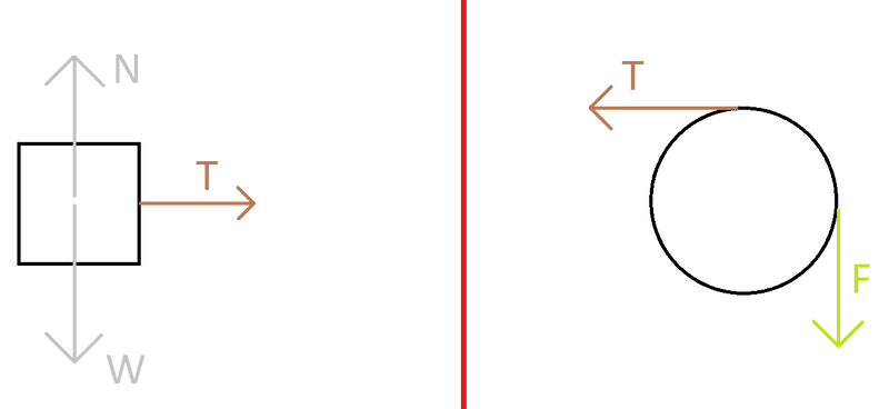

Alex126 said:
The "T" I drew quite clearly goes in the same direction as F,
Tension (and likewise compression) is not a force, exactly. It is more like pairs of opposing forces.
If a string is under tension T, then at each point of the string there is a force T pulling away from the point in each direction.
If you were to draw separate free body diagrams for mass and pulley then they should show a T pointing away from the body in each case.
Yea, got it. I think.
So if I drew the diagram only for the block, it would show these three forces: Weight, Normal force, and a Tension pointing to the right.
For the pulley, there would be two forces: F pointing down, and T pointing to the left.
The T from the block and the T from the pulley have the same magnitude, right?
If that's the case, then T = m*a (where this "T" is the one pointing to the right, when I isolate the first body) should have been correct, from earlier.
Likewise, for the Momentum relative to the pulley, the two forces playing a role here would be the F and the T which points to the left. Therefore, as I guessed earlier, the momenti were indeed +MF - MT = I*α
So this becomes:
1) r*F - r*T = I*a/r
2) T = m*a
=> r*F - r*m*a = I*a/r =>
=> r*F = a (r*m+I/r) => a = r*F/(r*m+I/r)
Is this it?
In this case, yes. When would they not be the same? Hint: draw a free body diagram for that section of rope.
Alex126 said:
a = r*F/(r*m+I/r)
Yes.

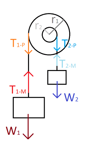

That's kinda what was bothering me, because I was thinking of other kinds of exercises. One in particular had two "concentric overlapping discs of pulleys" (I'm sure there is a better term to indicate this, but I don't know it) with two blocks hanging on either side. The two discs of the pulley system rotated together with the same angular velocity. It looked something like this:
Here T1-M is the tension T1 for the body, and it's equal (or rather, opposite) to T1-P which is the "counter-Tension" T1 from the "pulley's point of view". Same thing with T2, but T2 is different from T1. In this exercise we knew m1, m2, r1, r2, and the moment of inertia I (for some reason called J) of the "whole pulley" (i.e. considering the two discs as one object). I did this exercise basically the same way, except there were a few more things:
(m1 > m2, so assume counterclockwise rotation)
1) [First Body] +W1 - T1-M = m1*a1
2) [Second Body] -W2 + T2-M = m2*a2
3) [Pulley] +r1*T1-P - r2*T2-P = I*α
4/5) a1 = α*r1 ; a2 = α*r2
Here T1 and T2 were different, surely. Though I'm not sure this is the example you meant, since it's quite a bit far from the previous exercise :D
No, my question was when would a rope under tension exert a greater force at one end than at the other?
I guess when there is something else pulling on the other side...? Something like friction on the table maybe?
No. Bear in mind that in your question the system is accelerating. Draw a free body diagram for such a section of rope and consider the net force on it.
Oh, well, if there was no block then :D
No, there is no block to consider in my question. There is just a straight length of rope with a greater tension at one end than at the other. What normally happens if there are unbalanced forces on an object?
