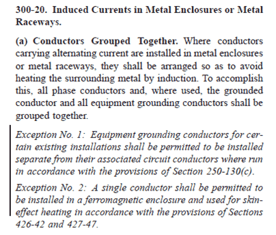

Steel conduit experiencing inductive heating is certainly not made up. See the attached section of the National Electric Code.

He thought it was a good idea until the wires started to heat up and melt.
he's not the first, by a long shot.
http://media.nowpublic.net/images//97/7/977a0e06c35f94412e56c9d32e1704f5.jpg
Those red magnetic lines heat iron . But it takes substantial current, like to a motor or something, to make it dangerously hot.
if the iron encircles the return conductor too then the two magnetic fields will cancel.
That's why that paragraph in electrical code says run them all together.
If you have a clamp-around ammeter , clamp it around both wires of a lampcord and observe zero reading. Then split the cord and clamp around either conductor observe you read lamp current.
Then repair or replace the lampcord.
