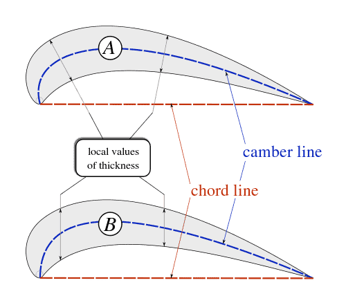

Well there is camber below the wing just like above just not as much. Bernouli is acting on the bottom just like the top. Just not as much since the velocity is greater on top due to greater camber above.
I'm not sure you realize that camber is the sum of the curvatures. There is only one camber.
And again: bernoulli deals with one flow scenario at a time. A stationary and a moving plane are different scenarios. This is your critical misunderstanding.

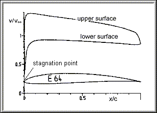

I have studied many diagrams and now understand the dynamic/static relationship.
There is an acceleration then deceleration of the flow over the wings curved surface...and the same over the wings curves surface under the wing. A gentler curve but a curve none the less. If Bernouli applies above the wing it does so also under the wing and that IS a fact.
So, as I understand it the static pressure reduction is what we are interested in when considering the difference between upper and lower wing pressures that produce lift, is that right?

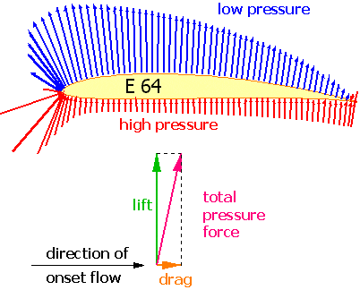

Of course Bernoulli's principle applies in both surfaces. But Bernoulli's principle applies to flows that both speed up and slow down. On the top surface it speeds up and on the bottom it slows down. Here's a diagram indicating the resulting pressure profile:
As you can see, the red arrows indicate pressure above ambient on the bottom of the airfoil.
Static pressure change. It can be an increase (on the bottom surface) or reduction (on the top).
Here's a diagram with a velocity profile:
https://www.mh-aerotools.de/airfoils/velocitydistributions.htm
Let us follow the flow from the stagnation point, along both sides of the Eppler E 64 airfoil at 2º angle of attack, as shown above:
  • Starting from v/
    =0 in the stagnation point, the velocity v increases rapidly to 1.38 times the velocity
    of the onset flow near the location x/c=0.1. Further downstream the velocity gradually decreases and reaches at the trailing edge approximately 85% of the free stream velocity
  • The velocity of the flow on the lower surface looks similar, but its level is considerably lower. In this example, it always stays below the free stream velocity.
You misunderstand airfoil terminology. Airfoils have three generally-important properties: angle of attack, camber, and thickness. Angle of attack is the angle the chord line (straight from leading edge to trailing edge) makes with the free stream. The camber line comes from starting at the leading edge and drawing a curved line to the trailing edge in a way that exactly half the thickness is above and below the camber line at all times. Thickness is, as was just mentioned, the distance from the camber line to the airfoil surface. See, for example:
thetexan said:
The same is happening on the lower surface but the static pressures are greater overall on the lower surface than the upper.
Not true, necessarily. As @russ_watters already pointed out with links and images, the flow under the airfoil is not necessarily accelerated at all, and is often decelerated. This is the meaning of that plot that shows the bottom side has a value of ##v/v_{\infty}<1##. In other words, the local velocity, ##v##, is less than the free-stream velocity, ##v_{\infty}##, and therefore the pressure there is higher.
thetexan said:
The stagnation point in the boundary layer (one of two) on the top of the wing is where the adverse pressure gradient causes a reverse flow towards the front and reaches equilibrium with the normal favorable gradient flow toward the rear. This stagnant barrier causes the boundary layer to separate from the surface as the rearward flow goes up and over the stagnation barrier.
That's not really a proper way to describe things here. In a boundary layer, the velocity at the surface is always zero relative to the surface. In effect, the entire surface is a stagnation point. The key to separation is the shape of the boundary layer. The typical criterion for defining the separation point is based on shear stress at the wall, which is proportional to the wall-normal derivative of the velocity in the boundary layer. When the shear stress is zero, the boundary layer separates and reverses downstream.

These students don’t get that deep into this. They understand the blausian graphs of the boundary layer and the point where the adverse gradient reverses the flow.
youre right. I’ve been saying camber when I should have been using the word “curved surface”. Because of the lower surface curve Bernoulli should work just like it does on the top surface as far as dynamic/static pressures are concerned. The main difference between upper and lower surfaces is that the lower surface, because of the typical positive AOA, is exposed to direct relative wind willing strikes the lower surface directly, adding a Newtonian reactive component to the total lifting force.
There is also the downwash deflecting of the upper flow also adding a reactive component from the top side.
