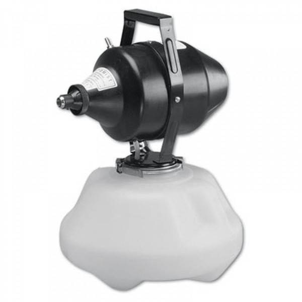

Got one of these, might play with it, was wondering how it might work as blower/mister all in one and it's an adjustable output, of course would need larger water feed...
Unit above mists out forcefully to over 25 feet and 95% of its output is less than 50 microns, most around 20 microns, so it'll evaporate readily. Can be dialed down to about 1.5 gallons per hour. I'm thinking if I did try this, I'd have first channel be a long straight shot for it, before first baffle change in direction, but have to find out first if it can handle extended lengthy operation.
