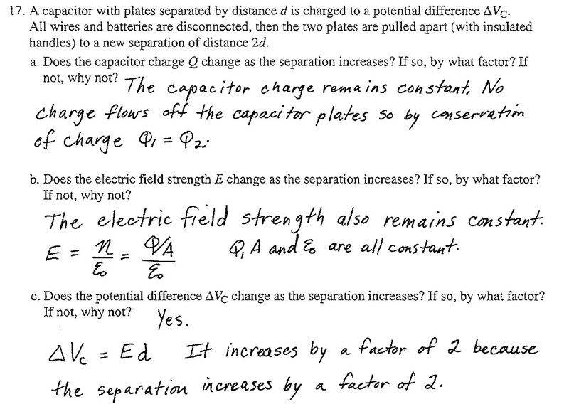

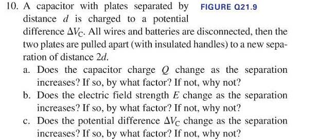

The Question is here:
imgur link: http://i.imgur.com/wIlUZMM.jpg
[tex]U_c = \frac{\kappa \epsilon_0 A d E^2}{2}[/tex]
[tex]U_c = C \Delta V_c[/tex]
[itex]\kappa[/itex]: dielectric constant
[itex]\epsilon_0[/itex]: permittivity of free space
[itex]C[/itex]: capacitance
[/B]
I understand why the answer to (a) is no, conservation of mass, and the charge can't flow anywhere since the system has been isolated.
But I got completely the opposite answers to (b) and (c) from a solution I found posted online.
My answer:
(b) The electric field strength decreases by a factor of [itex]\frac{1}{\sqrt{2}}[/itex]. This is required by the conservation of energy and the equation [itex]U_c = \frac{\kappa \epsilon_0 A d E^2}{2}[/itex]. Since the [itex]U_c[/itex] cannot change, nor can the [itex]\frac{\kappa \epsilon_0 A}{2}[/itex] all that [itex]U_c[/itex] is stored in the electric field. After all, a certain amount of work had to be done on the capacitor by a source to charge it to a particular voltage, and that work/energy can't just disappear. Will increased separation there is now more space for the electric field to "change the shape of", so now any given set of equipotential surfaces are now more spread out, lower V per meter, but more distance, lower force per Coulomb, less force on a given charge, but over a greater distance to give an overall same [itex]\Delta K[/itex].
(c) No, [itex]\Delta V_c[/itex] stays the same as it is proportional to the work done by the original energy source in separating the charges across the capacitor, so conservation of energy would prevent [itex]\Delta V_c[/itex] from changing.
The answer in a solution I found online is:
imgur link: http://i.imgur.com/SMSdxiO.jpg
The problem is, these solutions don't explain very much conceptually.
Firstly, am I wrong? Secondly, why? Why is the answer the opposite of what I've answered?

Although the charge is the same, the potential difference does not. This is easy to see by building a capacitor and charging it and measuring.
It takes more wotk to move the same charge between more distant plates, therefore, the more distant the plates, the bigger the potential difference.
Likes Grim Arrow
For b make a drawing of the capacitor with a small + charge in the middle between the two plates.
Would the force on the small charge increase, decrease or stay the same if distance between the plates is increased?

Think about like this, the charges on those two plates are attracting to each other, so if those two isolated plates are reconnected into a circuit, the charges will flow back onto the plates to finally give V=0, but while this is happening, the force of attraction across the capacitor (between the plates) will also be resisting the force of motion to return the charges to an evenly distributed state. This force of attraction between the plates opposing the force moving the charges back through the circuit will reduce the amount of work a current flowing in that way would be able to do. So the further apart the plates are, the less force of attraction between the plates is giving the back current through the reconnected circuit less opposition, enabling it to do more work, thus the plates further apart must be holding a higher voltage.
