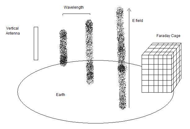

Hi everyone I have a question that has been bothering me for a while now. I have basically built a Faraday cage using wire mesh. I know there is a relationship between the mesh hole size and the wave suppressing ability of the cage.
As I understand it an electromagnetic wave can be thought of as a series of peaks of energy. Each peak being separated from the next peak by a given wavelength...What has this got to do with the size of hole that a electromagnetic wave can travel through? Why would smaller waves, such as the 3G signal on my phone pass through the hole and larger waves not?
Can somebody explain it in layman's terms so I can form a graphical representation of what is actually happening?

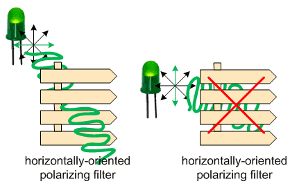

Imagine if you will a fence running alongside a road.
The fence is made of metal strips a few centimetres wide, stuck vertically into the ground, with the strips a few centimetres apart.
Now imagine standing directly in front of the fence - it is half metal, half air. A vertically polarised EM wave could pass through the gaps; a horizontally polarised EM wave couldn't, in all probability, and waves of polarizations in between could pass with varying degrees (sorry) of success. Now get closer to the fence and look along its length to its farthest point. The closer you get to it the smaller the gaps in the fence will appear to be and, sure enough, the closer the fence will become to a mirror to any EM waves you shine on it.
So the answer to your question involves EM wave polarization, conductor to gap ratio and general geometry of the cage and antennas and the ratio of wavelength to geometry.
I hope this helps a bit.
@Blibber:
From your description of the fence (with vertical conductors) you appear to have got the polarisation thing the wrong way round. Vertically polarised waves will excite currents in the vertical conductors and these will re-radiate the wave back the way it came. This may be counter intuitive but the same thing applies to thin wire antennae - they behave as if they had a very large effective cross section to parallel polarised waves. Horizontally polarised waves, however, will not excite currents in the conductors (assuming their horizontal dimension is small compared with the wavelength) so a large proportion of the wave's energy will pass through.
The actual width of the slats, the angle of arrival and their thickness will have an effect on exactly how much HP power will pass through. Fine square mesh works better than slats, of course.
Unfortunately, when you require good screening, the small currents that will be induced around on the other side of the screen, through the holes, may radiate an inconveniently high level. It may seem small in percentage but the effect of interference on equipment tends to be more logarithmic than linear so you may still have signals leaking through at perhaps -60dB less than what you got outside and that can be an embarrassment. This is why good screened enclosures are so expensive. Doors, hatches and cable entry points need to be given special attention if you want really good screening.

@ Blibbler and sophiecentaur- Thanks the reply, although it was really interesting, it never quite answered my question.
As Drakkith said, I am specifically looking for the reason why shorter wavelengths may pass through the holes and longer wavelengths do not...
@ sophiecentaur
When I place my mobile phone inside my Faraday Cage, the signal is attenuated but it doesn't disappear completely. In cellular and most commercial applications signals are vertically polarized.
According to your explanation the reason for this is because the wavelength between each successive energy peak is greater than the horizontal distance between the vertical conductors. As a result current is not exciting in the vertical conductors, and no wave is re-radiate back the way it came, due to the fact that their horizontal distance separating the vertical conductors is much shorter than the wavelength. As a result a portion of the waves energy will pass through the cage.
Is this right? If so, what effect are the horizontal conductors having on the vertically polarized mobile phone waveform signal? Surely they should be blocking it like it like a polarized filter does?

That diagram is just plain wrong. EM waves aren't like waves on a wiggling piece of string so the 'picket fence' analogy doesn't apply. Treat robotroom with care if that's the sort of thing they are saying. In fact, a 'polaroid' filter consists of molecules that have been stretched inside a plastic matrix and these behave like tiny wire dipoles and absorb light with a polarisation parallel to these dipoles. Thus, they block light with polarisation which is not like that diagram would suggest, at all.
The reason for the reflection of VP waves (VP means that the Electric field is vertical, btw) by vertical strips of conductor is because currents are induced in the long lengths of wire and re-radiate energy (the current is mostly induced on the side of arrival of the wave, too). It behaves just the same as a solid sheet. This is because a single (infinitely) thin wire 'intercepts' much more than its cross section might suggest; it has an effective cross section many times the wire thickness. However, if there is a big space (wrt the wavelength) between the vertical conductors then this will leave 'gaps' between the regions of influence of the wires and the screening gets less.
If there are no horizontal wires connecting the vertical conductors, HP waves will not induce any current so they will not affect the waves. The small horizontal extent of the wires would not allow any significant horizontal currents to be induced.
A mesh is more complicated but consider a mesh with very small holes compared with the RF wavelength. This will behave more or less like a sheet of metal because currents can flow along it in virtually any direction - finding their way across the surface even when they flow diagonally.
If the wavelength is very very short and the wires of a large mesh are very fine then most of the energy will go straight through as it will not interact with the conductors to produce currents. You can see through a chicken wire fence, which tells you that em of visible wavelengths gets through the holes undisturbed. For cm microwaves and a mesh size of a few cm, each hole becomes like an individual antenna. Wire dipoles and slots in metal sheets are equivalent and both behave as radio antennae. This is not very well known but an example is the antenna in your mobile phone that will almost certainly be a slot type (they don't use sticky up whip antennae any more do they?). If you take the back off some phones, you can actually see a system of L shaped slots, which is the antenna; have a look. Anyway, there are currents flowing around the inside of all these slots and energy will also be radiated towards the back of the mesh too.
Of course that's not the end of the story. Low frequency waves have a habit of inducing currents around the outside of a cage and producing nodes and antinodes. This can mean that a lot of current can be present at some points on its surface. If there happens to be a high resistance gap (seam or door) at this point, a relatively high voltage can appear, which can produce an E field inside the cage.

Thanks for your replies, this is what I am struggling with, what do electromagnetic wave look like when traveling from a vertical antenna?
An electromagnetic wave is a traverse wave. It's wavelength is the distance between two successive peaks separated in time. The peaks arrive one after each other. How I picture the wave doesn't tie into your description.
In order to understand your description I have to picture the faraday cage being perpendicular to the wavefront rather than head on, facing the antenna.
It doesn't "look like" anything. Any wiggly lines you may want to draw on a piece of paper are only 'graphs' to show the strength and direction of the electric and magnetic fields as they vary in space and time.
The wave that is launched from an electric dipole has its electric field parallel with the wires and, if you took an instant measurement of the fields at anyone time (A photograph of the graph) they would, as you say, vary from a maximum 'up', through a zero, down to a maximum 'down' and back through zero again as you move out from the dipole. The distance between successive positive maxima is called the wavelength. In time, the wave progresses outwards and if you measured the field at any point, as it varies in time, you would again get a variation up and down and back again. The rate at which this happens is called the frequency. If you multiply the wavelength by the frequency, that will tell you the speed at which the wave progresses. NO NET FORWARD MOVEMENT of fields or matter takes place.
btw, it is bad enough trying to discuss most aspects of electromagnetism, sensibly, using photons and it's even worse if you try to describe what goes on if you want to use photons and waves at the same time. You want waves, then talk in terms of waves. Sort that out first and then let QM come into the game - but only when you're quite sure you have classical wave ideas well sussed.
So would it be safe to say the EM radiation is a "disturbance" of an EM field that propagates outward but only transfers energy and interacts through specific quanta called photons? Or is that just way off?
I think that is absolutely right and, furthermore, there is very little else you can say, incontrovertibly, about photons. We'll be back on that other thread if we're not careful!
Interesting. That's a lot less confusing to me now. Not sure if that's a good thing or a bad thing!
I still can't see why the wavelength has anything to do with it graphically in my mind. I understand what you have say sophiecentaur, but still picture like this and can't understand why the wavelength has anything to do with the mesh dimensions...

No :cry: I need a picture of how it works. The wavelengths as you say are the distance between successive maxima peaks separated by time...if that is still the case why should the separation distance between the vertical wires have anything to do with it?
This is what I understand so far...
When electromagnetic waves are polarized vertically they have a component of their electric fields aligned parallel to the vertical wires that induces the movement of electrons along the length of the wires. Since the electrons are free to move in this direction, the vertical wires behaves in a similar manner to the surface of a metal when reflecting light; and the wave is reflected backwards along the incident beam.
For waves with electric fields perpendicular to the wires, the electrons cannot move very far across the width of each wire; therefore, little energy is reflected, and the incident wave is able to pass through the mesh.
What I don't understand is why the separation distance between the vertical wires must be less than the wavelength of the wave. I can't picture why this is and its keeping me awake :eek:

My confusion is boiling down to the definition/illustration of the wave length in a vertically polarized wave...
This cross sectional image explains how a vertical antenna emits a wave.
http://www.measurement-testing.com/Electromagnetic-wave-transmission.jpg
Is it correct to say that if I was to place my faraday cage in the middle of that waveform, the only side of the cage that would allow wave to pass through are the sides that are perpendicular to the electric field? Assuming adequate wire separation distance
That diagram shows the Electric fields. They are parallel with the dipole (in the equatorial region). The 'holes' are where the field changes direction and there is a half wavelength between successive holes. Look at the rather jerky animation on one of my links, above. I have a feeling that you are confusing the Fields with the Waves. That diagram of yours explains it perfectly well.
The side of the cage that will be affected most will be the side which is parallel to the field that 'would have been there' and on the side facing the source. Of course, once the cage is there, there will be currents in it that will distort the field.
Think about it - you don't point an antenna at the transmitter. You put it parallel with the transmitting dipoles and at right angles to the direction of arrival. So the wires of the cage that count will be parallel to the incident E ('transverse') field.
Once the cage is in place, some currents will appear even around the sides, which is why just standing behind a flat screen of finite size will not give total screening. Currents find their way round the edges and radiate behind the screen.
