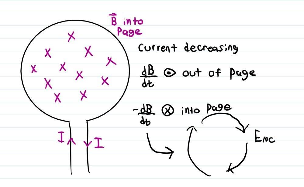

I understand Faraday's law and about induced electric fields created by a changing magnetic fields, etc.
But what causes the current to oscillate in an LC circuit, with no battery? If you picture that there is current going into an inductor, and that current is decreasing over time, then you would see a curly electric field being produced in the direction of the current flow. (I uploaded an image for my reasoning)
Also, why would the current decrease at all? If inductors "oppose" change, wouldn't it make sense that the curly electric pushes the current to counteract the decreasing Coulombic electric fields?

The decreasing current in the inductor does indeed produce a change in the magnetic field that makes the current continue.
The current however is going into the capacitor and the voltage across the capacitor will increase, and that will make the current stop and then change sign.

##v= L\frac{d}{dt}i## and ##i=-C\frac{d}{dt}v##
so ##i=-LC\frac{d^2}{dt^2}i##
and therefore the current oscillates

The definition of a capacitor is ##i= C \frac{d}{dt} v##. In other words, a capacitor is a device where the current through the device is proportional to the change in the voltage across it.
The definition of an inductor is ##v=L\frac{d}{dt} i##. In other words an inductor is device where the voltage across the device is proportional to the change in the current through it.
In a LC circuit the current through each device is the same and the voltage across them is opposite, so when you write the expression for the circuit you get ##i = -LC \frac{d^2}{dt^2} i ##, which we immediately recognize as the equation of an oscillator.

Both the capacitor and the inductor are necessary. It is like asking if the spring or the mass causes the velocity to reverse in a mass-spring oscillator. Without both parts you don’t get oscillation.
That said, at the moment when the current switches from positive to negative (or vice versa) the magnetic field is zero and the electric field is maximum.
