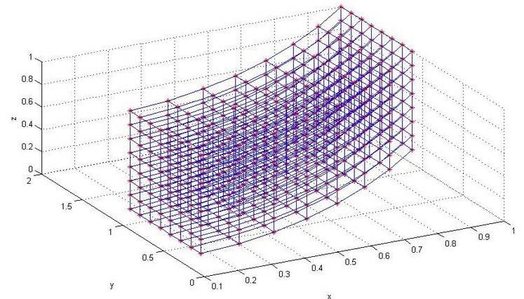

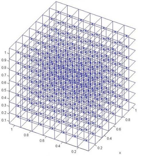

Sadly, though I surely appreciate everyone's posts, and will read them repeatedly, I'm no closer to understanding. Why can an object in the center of the flat spacetime grid sit still, moving only in the dimension of time, yet it must move in the dimensions of space in the curved spacetime grid?

  • #31
Motion is relative. So in either curved or flat spacetime an object can always regard itself as stationary. Note that your diagrams are potentially somewhat misleading in this context, because they show a grid that something might move relative to - but there's no such thing in spacetime. Unless you build one out of girders.
I think what you want to ask is why do objects follow curved paths in curved spacetime. The basic answer to this is "that's what they do". Why do things travel in straight lines in flat spacetime? It's just what they do. We can explain this in terms of extremising the action (the Lagrangian methodology @PeroK mentioned), but this is merely a mathematical way of saying "because they do".
At some point, you run into the fact that we don't know everything. General relativity simply models spacetime as an entity whose rules of geometry depend on mass and energy. Things follow curved paths because the geometry is not Euclidean. But why that should be, we don't know.

Objects in either grid can follow the time dimension of the grid. To follow the straight grid the object’s worldline must be straight. To follow the curved grid the objects worldline must be curved.

Patterner said:
What I *think* I want to ask is why do objects *have* to move in curved spacetime if they do not have to move in flat spacetime. Things can exist in curved spacetime without moving in the dimensions of space.
The term "moving in space" always means "moving in space relative to something", whether the spacetime is curved or not. The apple hanging on the branch is not moving in space relative to an observer standing on the ground; but an observer on Mars looking at the apple through a telescope will say that it is moving (along with the rest of the earth) through space at a speed of many kilometers per second.
Break the stem and let the apple fall, and now the apple will be moving in space relative to the surface of the earth; but it will not be moving through space according to an observer falling along with the apple.
Likes bhobba
  • #35
Based on your statements I think that your question is actually about curved grid lines (coordinates) rather than curved spacetime. If you have coordinates where the time axis is straight then objects that follow the time axis must have straight worldlines. If you have coordinates where the time axis curves then objects that follow the time axis must have similarly curved worldlines.
An apple on a stem has a curved worldline and an apple in free fall has a straight worldline.
Likes bhobba
