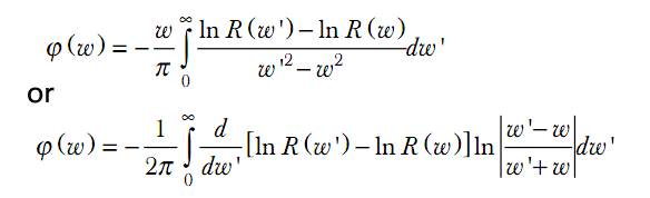

I try to extract optical constants (complex refractive index) from the spetral reflectance data - R(omiga), the common method is using Kramers-Kronig relations to calculate the Phase information of the reflection - Psi(omiga), then according to the normal reflection coefficients, the complex refractive index can be extracted. But in the practice, I found the results didn't look appropriate, so i guess the phase angle-Phi(omiga) may be calculated uncorrectly, and can not find the mistake for a long time. So, indeed need your expert advice and help, if you have the right tool, can you calculate the results for me? thank you.

the main calculate formation as listed below:

Why the calculated phase angle have positive and negtive values both? that is also the reason why k have positve and negtive values both. I thought maybe the wavelength region is not wide enough, but from some refrences it should can be calculated. Is there something Wrong in my code? but i think it is right ... I am confused by the Kramers-Kronig calculation...:cry:

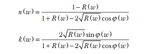

Btw. Shouldn't there be a cos(phi) in the formula for n?
the formula has no problem, it can be found in many reference...

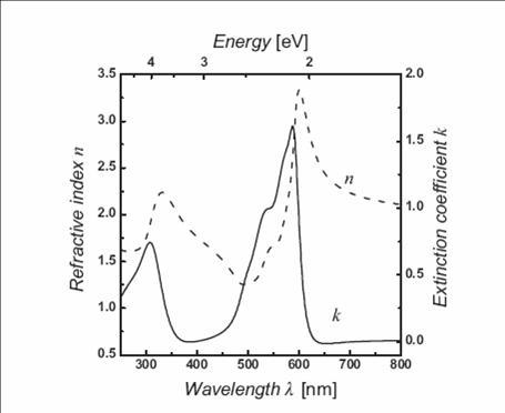

complex refractive index always in the form n^=n+i*k, for the real part n is the refractive index, imaginery part k is known as absorptive index (absoption coefficient alpha=4*pi*k/lambda).
how to say the calculated k has a dispersive shape and n an absorptive one? the measured material is Cr2O3, commonly its n should be greater than 1, and k is great than 0, attached picture is the n&k of some meterial (SubPc). why the calculated k is less than 0 and n is less than 1?
