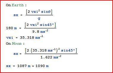

If you can hit a golf ball 180m on Earth, how far can you hit it on the Moon?
Since this question deals with range;
sx = [vxi^2 sinΘ]/g
My problem is that I do not have the velocity at which the golf ball is being hit. As for the launch angle, I could make a probable assumption that the golf ball is launched at a 45°.
Would I be valid to make the assumption the ball would travel 6x further on the Moon than on the Earth given the gravitational pull on the Moon is 1/6 that of Earth?

negation said:
sx = vxi^2 sinΘ
You've left a very important term of that equation.
(It's obviously wrong because the dimensions don't match. You have a distance on one side and the square of a velocity on the other.)

negation said:
I carelessly left out the time variable, t.
No, that's not what's missing. Check where you got that equation from.
It has been corrected: sx = [vxi^2 sinΘ]/g after having derived it from the trajectory equation.
Right, and from that you can see that the distance is inversely proportional to the strength of gravity. So your guess was right: one sixth the gravity means 6 times the distance.
sx = [vxi^2 sinΘ]/g
The equation is wrong.

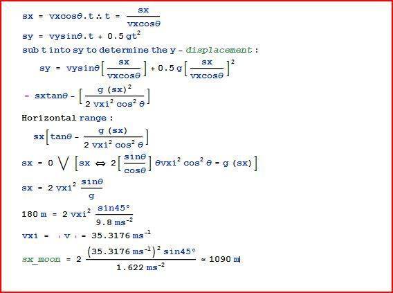

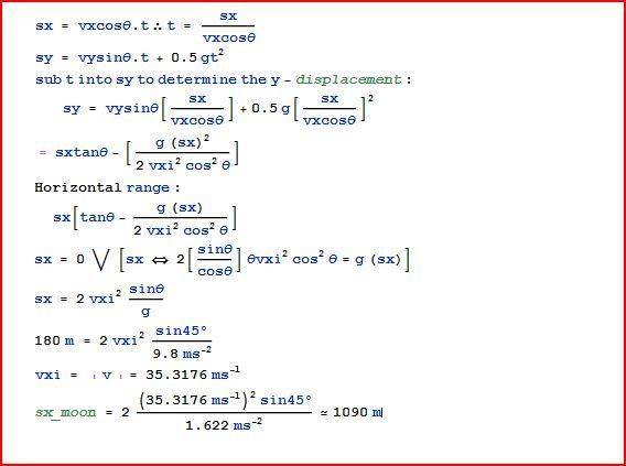

I managed to obtain the right answer. I have poor memorizing abilities and as such I derive equations I require(very time consuming).
The formula I derived is x = [2vxi^2sin45°]/g
This enables me to obtain vxi. After which I use the above formula to determine the x-displacement on the moon.
I wonder how you got that formula...
ehild

ehild said:
I have used my own arbitrary label of the variables but they essentially implies the same thing.
In my formula, I determine the time taken for the particle to travel from xi to xf.
The time taken for particle to be displaced from xi - xf can be substituted into the y-displacement equation to determine the displacement of the particle along the y-axis-this allows me to determine the x and y coordinate of the particle at a given time.
Simplifying the equation where t = sx/ vicosΘ into the y = visinΘ-0.5gt^2 produces a quadratic equation which allows me to determine the 2 possible x-coordinate of the particle where y = 0 since the trajectory has a parabolic characteristic.
In simplifying further, I obtain x = 2vi^2sinΘ/g; given 3 known variables, I can find the one unknown.
I saw the reasoning in the link you provided. The reasoning in the link begins by using the y-displacement equation to determine the time taken for the particle to be displaced from yi to yi. Then it subs that amount of time into the x-displacement equation to determine the horizontal range the particle travels in that same amount of time.
As for the formula I used, I begin with determining the time taken for the particle to be displaced from xi -xf.
So what are vx and vy (or vxi and vyi) in your derivation?
That is still wrong. ehild
negation said:
it works fine...
The line that start "sx = 0 V" is fine (except for a spurious extra θ), but in going from there to the next line you dropped a cos(θ).
There is an easier way: forget sy, compute the flight time. Time to reach apex is vy/g.

negation said:
I saw that. It was a typo but, admittedly, I was lazy to have it changed.
OK, but that's why you got this wrong formula: x = 2vi^2sinΘ/g
What formula do you get now?
I got this: x = vi^2sin[2Θ]/g
I made a careless mistake by overlooking the trig identity where 2cos(x)sin(x) = sin(2x):
Good.
