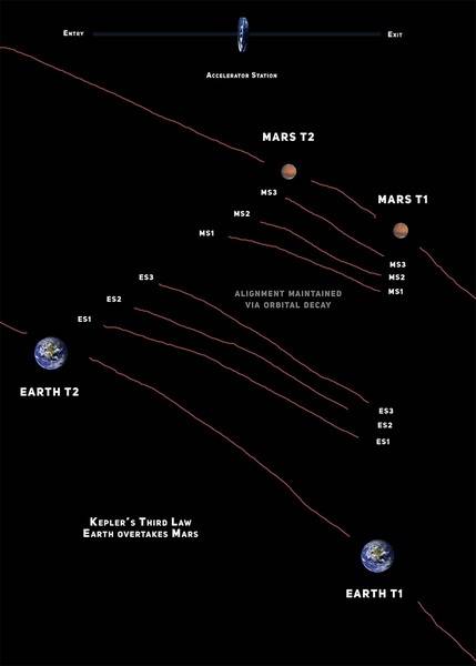

I guess megascale catapult is a good way of putting it. I imagine many of these in series, giving a rather brisk push to the craft at each stage. I thought a nice trick would be that you need to get a "partner" coming back the other way (Earth -> Mars, Mars -> Earth) of either another craft or you pay additional tax for them to send ballast / raw materials back the other way. That way the mass drivers, after all the catapulting has been done, waste as little precious fuel as possible station-keeping themselves. Supposedly the series of relays at the other end then slows them down. Perhaps they also are used, while they are in transit, as a drop-off vehicle to certain space-corridor-units. Perhaps each vehicle drops off 2 or 3 canisters of fuel and preprogrammed relay points (Sorry, getting rather deep in the whole fantasy technobabble. The point is it's just a way of leveraging movement in both directions and offsetting a large part of the propulsion to some sort of space infrastructure, leaving the craft propulsion system to course correct I guess).
EDIT: Oh, and of course, such a corridor would only be "open for business" at certain times of the earth/mars orbit.

Oh I see what you mean now, so the idea would be to have X number of smaller accelerators spread between Earth and Mars that each speed up/slow down traveling ships?
Unfortunately there are two major problems with that:
1) One 100km accelerator and one-hundred 1km accelerators are entirely equivalent from a basic physics standpoint. All the calculations above still apply in terms of energy, g-force etc. You're just inserting breaks in the sequence.
2) Objects don't just stay floating in place in space. Even if you strung up a perfect line of accelerators between Earth and Mars they would instantly fall out of line. Not just because the two planets are orbiting at different distances/speeds but because every accelerator is orbiting the sun at different distances/speeds. Calculating planetary alignments is quite hard (if you google it you can find some examples) and gets a lot harder the more you have. It's not just a case that Earth and Mars would have to be in the right orbits but every single accelerator would have to be too.

It still applies, yes, but the requirement to accelerate them to at least escape velocity is no longer a requirement. They already have escape velocity. This is then allowing more of the vessel to be actual useful cargo as opposed to rocket fuel, similar to gravity assist and beam propulsion you mentioned.
I agree. From what I have gathered, maybe this thing could be set up to align with a gradually decaying orbit (around the sun) with all accelerators being given a distinct orbital decay so to keep the alignment for the duration of the window. Unless someone tries solving those equations to see if there actually exists orbital decay points that do maintain alignment, I'll be happy with it just being sci-fi gloss. If I pretend that there is a solution, then the by product of the orbital decay would also be that the stations would grow further apart by the end of the window. This hopes that there exists a solution between orbital decay and alignment that does not require constant adjustment. Not very good odds, so it looks like it is improbable or very costly to maintain such alignment.
Perhaps your version of space catapult is more viable! Have you thought about what such a device could do if it were in space but significantly slower / scaled down? if I have a single launcher and a receiving station on either end. At least that way you it just has to worry about the end trajectory only. With aerobreaking that does solve the issue of slowing down on the other end but then we lose the benefit of a return craft putting the opposite inertia on the station, thus if we were using such a system to launch many hundreds or thousands of craft, the net result in both directions keeps the stations from being pushed too far in the other direction without wasting too much of their own fuel.
