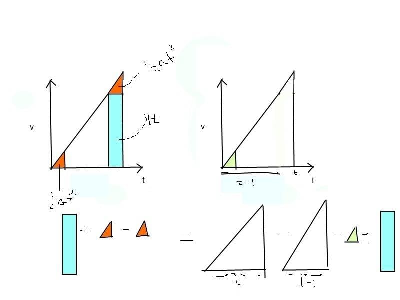

How far does a bubble in a glass of beer travel in its first and last second?
In summary: It is going to go 1/2(5 m/s)(3 s)^2 in 3 seconds, and the original 40 m/s (3 s).It is starting from rest during the last second. It's not starting from rest for its entire travel, but it is starting from rest for the last second. If it weren't, then the 2nd second's distance traveled would be more thanD2 = (1/2)*a*t2s2because it would ALSO have the velocity of the first second's motion, which the last second does not have. So the answer would be more thanD2-D1 = (1/2)*a*t2s2 - (

A bubble in a glass of beer releases from rest at the bottom of the glass and rises at acceleration, a, to the surface in t seconds. How much farther does the bubble travel in its last second than in its first second?
A) at
B)(t-1)a
C)(t+1)a
D)(1/2)at
y=vt+(1/2)at^2
1st sec: (1/2)at^2=(1/2)a
2nd sec: Vt+(1/2)at^2=V+(1/2)a=at+(1/2)a
2nd-1st=at+(1/2)a-(1/2)a=at
I think it's A but the book says B bc 2nd sec should be Vt-(1/2)at^2, but why would the acceleration be negative?
Thanks

"That is, if you are computing the total distance starting from rest (v0 = 0)", it's NOT starting from rest during the last second! I'm hung up on velocity because it gives the rectangular area under the velocity graph (displacement). Something traveling initially at 40 m/s with an acceleration of 5 m/s is not going to go 1/2(5 m/s)(2 s)^2 in 2 seconds, that would only be the distance traveled due to the increase in velocity (the trianglular area under the velocity graph)...it would go an additional (40 m/s)(2 s), right?
Aha! Vt gives at, which gives the rectangular area it would travel if its velocity had been its max velocity during the last second, so (1/2)*a*t^2 must be subtracted to give the proper displacement. Otherwise, it should be vt-1=a*(t-1). Does this make sense to anyone but me?

Finally I think I see where you're coming from. Using subscripts to indicate which velocity you're talking about sure helps!
Yes, the velocity, Vt, at time t is given by Vt= a*t. And you're correct to say that the distance the bubble would travel if it had this velocity for one second would be Vt*(1s)=Vt=a*t. But since the bubble has been accelerating (positively), its velocity was less than Vt during the last second of time, except right at the final time, t. The displacement during the final second is indeed
xt - xt-1 = Vt*(1s) - (1/2)*a*(1s)2 = a*t*(1s) - (1/2)*a*(1s)2 = a*t - (1/2)*a. This does NOT mean that the acceleration is negative. It means that at an earlier time the velocity was less that it was at the final time.
You can get the same answer by looking at the velocity, Vt-1, at time, t-1, i.e. 1 second prior to the bubble reaching the surface.
Vt-1 = a*(t-1) = a*t -a*1 . Of course if we multiply this by the time interval of 1 second, the resulting displacement will be too small by the amount, (1/2)*a*(1s)2. The displacement during the final second is:
xt - xt-1 = Vt-1*(1s) + (1/2)*a*(1s)2 = a*(t-1)*(1s) + (1/2)*a*(1s)2 = a*t - a + (1/2)*a = a*t - (1/2)*a , which was obtained without any negative acceleration, although the last expression may appear as if a < 0.
By the way, using your reasoning, you could just as easily argue that the acceleration during the first second is negative.
At time t=1, V1 = a*(1s) = a, and V1*(1s) = a. But the displacement during the first second is only
x1 - x0 = (1/2)*a*(1s)2 = (1/2)*a, so you need to subtract (1/2)*a. I.e. you can get the displacement during the first second by
x1 - x0 = V1*(1s) - (1/2)*a*(1s)2 = a - (1/2)*a = (1/2)*a, which may look as if a negative acceleration were used.
negative acceleration could come from the viscous force by the liquid on the bubble?
Awesome, that's exactly what I was trying to say. I was, before a day or so ago, unfamiliar with the idea that you could use Vf in the spot that I thought was reserved for Vo in the distance equation (and then obviously the (1/2)at2 is subtracted, which made me think acceleration was negative). Thanks for your comment, SammyS, you said what I was trying to say in the previous post much better than I did.
Gneill, after playing around with graphs for a while, I finally understand that you're absolutely correct, and thanks for staying with me this long. It took me a while to realize that dt was the entire displacement (the triangle with base t), dt-1 was everything traveled in time t-1 (the triangle with base t-1), and taking the difference gives Vt-1t+1/2at2. I kind of assumed that because and then subtracting 1/2a gave the difference in distance between the last and first seconds, which was, ironically, a(t-1)(1), or Vt-1. :)
Thanks again for the help.
