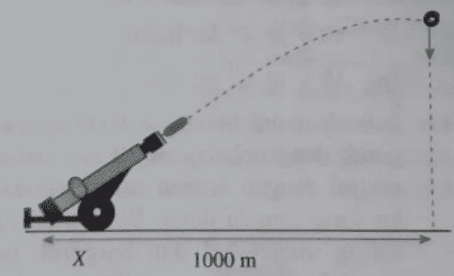

A projectile is fired from a cannon at position X. At its highest point, it explodes into two equal parts. One of the parts falls vertically (as shown in the figure) and lands at distance of 1000 m from X. How far (horizontally) will the second part land from X?
a. 1000 m
b. 1500 m
c. 2000 m
d. 2500 m
e. 3000 m
Conservation of momentum
At first, I want to use conservation of momentum when the object explodes at the highest position but I think the projectile is not a closed system (there is weight acting on it). Tried conservation of energy but not enough information provided.
What approach should I take for this question?
Thanks

I think I get the result. Since the horizontal momentum is conserved, the second part of the projectile will move to the right because the other part of the projectile undergoes vertical motion with zero initial velocity.
Using conservation of momentum, the speed of the second part of the projectile is twice the initial speed of the projectile before explosion (because the mass is half of initial) so the horizontal distance traveled will also be twice (measured from highest position)
I get the answer is (e)

kuruman said:
What does conservation of linear momentum have to say about the motion of the center of mass when collisions (or explosions) occur? If the projectile did not explode, would it land at a different point from that of the center of mass of the exploded projectile?
Ah. This clicked it for me. Once you determine the motion of the CoM, the correct answer follows intuitively.
Elegant solution.

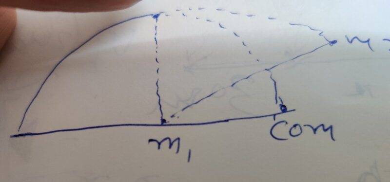

If we know that com will take the projectile path as if the explosion hadn't occurred, then can we not say with certainty that when com hits ground, then both exploded parts must also hit it otherwise the com would be above ground level due to the line joining the two parts being slanted to the ground?
For example, the com would be above ground along the slanted line ##m_1m_2##, if both parts didn't touch ground at the same time as com touching the ground.
[If we allow a non-horizontal explosion then] One part can hit the ground first. At which point the center of mass will no longer be in free fall since an external force acts on part of the system.
Was my logic for saying that com should touch the ground at the same time as it's components correct?
If I understand the logic, it is that:
Neither part can tunnel under the ground. If the center of mass is at the ground then both pieces must be on the ground. Proof by contradiction -- if one mass were above ground and the other no lower than the ground then the center of mass would be above ground.
That logic is reasonable. But it provides no assurance that the center of mass is in free fall all the way to the ground.
Likes vcsharp2003
Yes, the fact that the CoM hits the ground is no guarantee that the two fragments will hit the ground at the same time. Here is the mathematical proof that compares the unexploded trajectory with the trajectories of the to equal fragment.
Let ##V_{0x},~V_{0y}## be the components of the initial velocity. The maximum height where the explosion occurs is ##H=\dfrac{V_{0y}^2}{2g}##. The time of flight for the unexploded projectile is ##T_{\!f}=\dfrac{2V_{0y}}{g}## and the time elapsed until the explosion occurs is ##\frac{1 }{2}T_{\!f} = \dfrac{V_{0y}}{g}##.
Now assume that when the explosion breaks up the projectile into two equal pieces, piece A falls vertically to the ground it has initial velocity ##\vec v_A=\{0,-v_y\}## while piece B has velocity ##\vec v_B=\{2V_{0x},v_y\}## in accordance with momentum conservation. The vertical position of the CoM is $$Y_{\text{cm}}=\frac{\frac{m}{2}y_A+\frac{m}{2}y_B}{m}=\frac{1}{2}\left(H-v_yt-\frac{1}{2}gt^2\right)+\frac{1}{2}\left(H+v_yt-\frac{1}{2}gt^2\right).$$With ##H=\frac{V_{0y}^2}{2g}##, this becomes, ##Y_{\text{cm}}=\frac{V_{0y}^2}{2g}-\frac{1}{2}gt^2## which gives the time of flight for the CoM after the explosion, ##T_{\text{cm}}=\frac{V_{0y}}{g}=\frac{1}{2}T_{\!f}## as expected. The CoM will land horizontally at the same spot as the unexploded projectile as long as the fragments are in free fall for at least time ##\frac{1}{2}T_{\!f}.##
We can now find where the pieces are vertically when the CoM lands.
$$\begin{align} & y_A=\frac{V_{0y}^2}{2g}-v_y \frac{V_{0y}}{g}-\frac{1}{2}g\left(\frac{V_{0y}}{g}\right)^2=-v_y \frac{V_{0y}}{g}\nonumber \\ & y_B=\frac{V_{0y}^2}{2g}+v_y \frac{V_{0y}}{g}-\frac{1}{2}g\left(\frac{V_{0y}}{g}\right)^2=+v_y \frac{V_{0y}}{g}\nonumber \end{align}.$$This shows that if we know that the CoM hits the ground at the same spot as the unexploded projectile, then the two fragments will hit the ground at the same time only if the explosion imparts no vertical momentum to them (##v_y=0##). It also shows that for the CoM to land at the same spot as the unexploded projectile when ##v_y\neq 0##, fragment A must fall through a hole in the ground as @Steve4Physics has argued.
Now consider the hole-in-the-ground suggestion by @Steve4Physics and assume that fragment A keeps falling through it until the fragment B lands. We know that the CoM lands at the same spot as the unexploded projectile at horizonttal distance ##\Delta X_{\text{cm}}=V_{0x}(\frac{1}{2}T_{\!f})=\dfrac{V_{0x}V_{0y}}{g}## from the point of the explosion. To find where fragment B lands, which is the goal of this problem, first we find its time of flight, $$0=\frac{V_{0y}^2}{2g}+v_y t_B-\frac{1}{2}gt_B^2\implies t_B=\frac{v_y+\sqrt{V_{0y}^2+v_y^2 }}{g}.$$Then we can find where the second fragment lands horizontally from the point of the explosion, $$\Delta X_B=2V_{0x}t_B=\frac{2V_{0x}\left(v_y+\sqrt{V_{0y}^2+v_y^2 }\right)}{g}.$$It should be clear that unless we know ##v_y##, we cannot predict where the second fragment will land. If we are not given ##v_y## explicitly we can infer that it is zero with statements such as
(a) Both fragments land at the same time;
(b) Fragment A drops straight down with zero initial vertical velocity;
(c) Fragment B has zero vertical initial velocity.
Lacking such statements, as is the case here, we have to assume that ##v_y=0##, otherwise we cannot answer the question.
Summary
This question can be answered directly by observing that fragment B takes the same amount amount of time to come down as it takes to go up to max height. Since its speed is doubled at max height, it must cover twice the horizontal distance during the down trip.
On edit: Corrected subscript typos and added the summary.
Likes songoku and vcsharp2003
  • #33
So, what was wrong in my logic presented in post#27? I am still trying to figure out where in my logic I overlooked some other facts.
I am unable to come up with a scenario/example where they do not hit the ground simultaneously.
From my logic in post#27, it would automatically follow that the vertical part starts with 0 initial velocity and the other part starts with horizontal velocity, since only then would the fragments reach the ground at the same time as com of whole mass.
  • #34
A = vertically falling fragment (say with non-zero intial vertical velocity).
B = other fragment.
I think the fact that you overlooked in Post #27 is that if A hits the ground first, a new external force acts on A. As a result, the CoM no longer follows its original trajectory.
For the CoM to follow its original trajectory, we need (for example) a deep hole in the ground - so A continues (in free fall) down the hole. Then no new extenal force acts on A while B is also in free fall.
  • #35
And above would happen only if fragment A would explode off with a non-zero vertical velocity. Is that correct?
