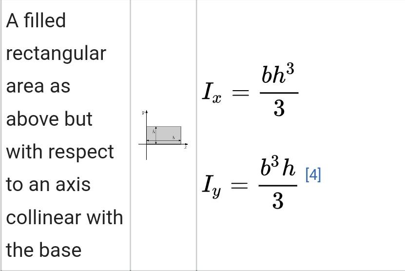

I decided to solve it on my own. But I have one question. How could I calculate the Moment of Area of the cross-section of the beam? That's the only thing I have no idea what it is and how to calculate it.
I found this. How can I make from Ix and Iy one I to put it to the equation? Just by pytagoras theorem?
So for the deflection I found a formula P.L^3/(48.E.I)
The right answer should be 3,33cm
I calculated Ix and put it there to the formula and what I got is 3,39cm.
Is my work at least a bit correct?
So for the second moment of area, we take this about the axis passing through the centroid of the cross-section as that is the axis which the bending moment is being calculated about. You could get the correct second moment of area by using the parallel axis theorem in reverse or just looking it up. The latter yields [itex] I_{centroid} = \frac{A h^2}{12} [/itex] where h is the height of the cross-section and A is the cross-sectional area.
Try adjusting your moment of area and re-doing the calculation. However, dividing by a smaller [itex] I [/itex] will increase your deflection, so I would double check your young's modulus (E) number to ensure it is correct.
Hope that is of some use.
[Edit] I have just re-read an earlier post and see the dimensions of the beam are not the same, thus requiring you to know the orientation of the beam. Therefore, the second moment of area will depend on the orientation of the beam so you know which dimension is the height and which one is the base.

Yeah no worries I know which one is the base and which one is height. Thank You for your help guys. I solved it with your help finally :)
