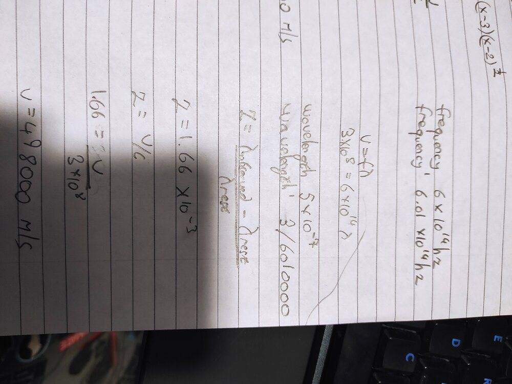

z= λ observed - λ emitted/ λ observed
A type of star that usually emits light at a frequency of 6.00 × 10^14 Hz appears to emit light at a frequency of 6.01 × 10^14 Hz.
Calculate how fast the star is moving, and if it moving towards us or away from us.

yeah sure
Please post a better image of your work (not sideways, good contrast and legible), or better yet please type your work into the forum. See the LaTeX Guide link in the lower left of the Edit window to learn how to post math equations here. Thanks.

The answer looks correct, although you don't say what's the direction of motion.

Did you consider doing a bit of algebra to get ##z## in terms of frequencies before you plugged the numbers in?
