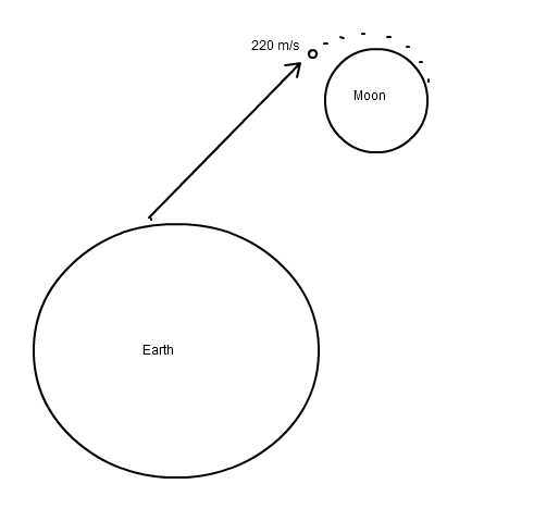

Is there any way to reduce the impact speed?
Or might it be possible shoot the bullet into lunar orbit?
A decaying/sub-orbit that ends with a softer landing would be good too!
Am I right in saying it is not possible to shoot anything into Earth orbit without a trajectory correction? Even if shot at a very shallow angle (1 degree) at a precise velocity?The mass of the "bullet" would be 10kg. Would a larger mass (100kg) help the above questions?
Could you use the gravity of the moon to slow the bullet further?
If you shot just "in front" of the moons path, and the bullet moves around to the darkside, it is pulled around the moon and towards the surface by the moons gravity, slowing it down, before it finally lands, at less than 220 m/s?
I'm not sure how far around would be optimal, maybe down almost straight away (we aim closer to the surface), or maybe half an orbit or more.
See my crude illustration attached.
The best you can do is place it at rest with respect to the Moon and then have it fall toward the Moon from there, but it will still impact at over 2300 m/sec.
We already showed that it can hit directly at only 220 m/s without any gravity assist.
That's not what that post says: that post was referring to the speed at the Legrange point.
There really isn't anything that can be done without power to slow the impact speed: it can't be much below escape velocity otherwise.
Correct.
Janus is right. You can't approach the Moon from beyond its orbit and crash into it with anything less than its escape velocity. It violates the Law of Conservation of Energy. At best you can have 0 Potential Energy at infinity. Subtract that from its PE at the surface (-GMm/r) for a change in Potential Energy. All that lost PE will become Kinetic Energy. So about 2300-2400 m/s is the slowest you can land unpowered.
