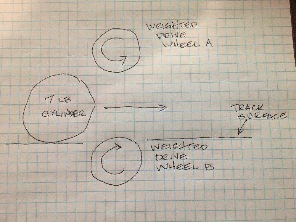

Hello,
I am hoping someone on the forum can help me. I am designing a machine to move a cylindrical weight between to high speed rollers.
The system is comprised of two weighted drive wheels being spun by motors positioned one above the other as shown in the sketch. The weighted drive wheels are 6 lb each and are 4.25" in diameter and 1.6" wide. A 7 lb cylinder 8.5" in dia and 10 in wide is rolling toward the spinning drive wheels on a guiding track at 2 miles and hour. The drive wheels are spaced so they both make contact with the passing cylinder. The surface of the drive wheels is a slightly compressible elastomer. The passing cylinder has a urethane surface. My question is how fast will the cylinder be propelled assuming that both motors are:

spike3333 said:
Is there an equation that could be developed that I could predict the speed of the cylinder.
There is an optimal spacing, and a thought experiment will show how to find it. If the spacing is too large, the drive wheels will skid on the cylinder, and the cylinder will not reach the speed of the drive wheels before it exits the drive wheels. If the spacing is slightly too small, energy will be lost over compressing the drive wheels. If the spacing is much too small, the cylinder will jam between the drive wheels.
Then, you need to consider the speeds of the two drive wheels. If they run the same speed, the cylinder is not rotating when it leaves the drive wheels. It would then skid on the track surface until it starts rotating fast enough to roll without skidding. Or you can run the drive wheels at different speeds so that the cylinder rolls without skidding when it leaves the drive wheels. What should the relative speeds of the two wheels be?
Hint: What is the speed of the wheel surface at the point in contact with the track relative to the track surface when it is rolling without skidding.
Think about this for a while, then come back, and we will help you take it further.

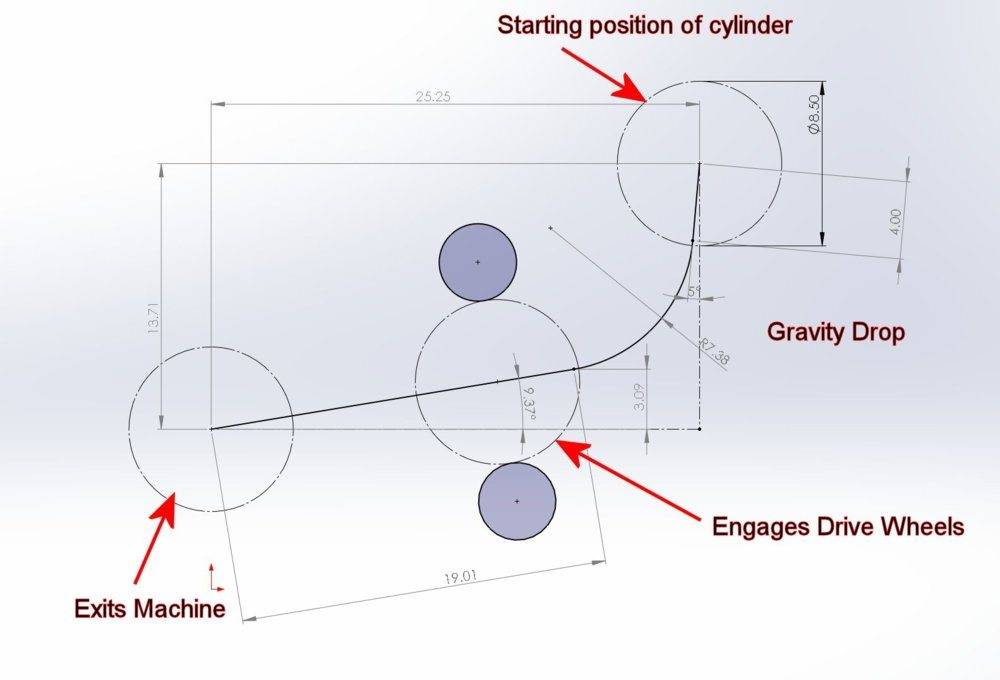

To assist in the calculation, the cylinder is dropped into the machine through a chute with Delrin rails via gravity until it engages the drive wheels. After it engages the drive wheels it continues on Delrin rails until it exits the machine. The goal is to propel the cylinder at the maximum speed possible with two 150 W DC motors of comparable size to the samples stated. I would assume that you would want the lower motor to match the speed of the cylinder as it engages the drive wheel and the upper motor to be at maximum speed.
I included a profile of the path through the machine to calculate the cylinder's velocity due to gravity at the point it contacts the drive wheels
Makes sense.
You should re-read the Hint from jrmichler once more.

Yes, the cylinder is dropped into the shoot from above and is rolling when it engages the wheels. Yes, I want to reach 20 MPH or as close to it as I can.
I don't see how driving the cylinder from the end is more efficient or simpler, especially if a motor can be eliminated. Can you explain why you feel it would be?
Yes, the cylinder is rolling down Delrin rails in such a way that the cylinder is kept centered while it is rolling.

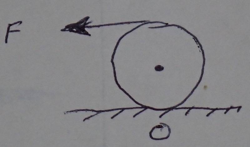

The key problem here is how to calculate a case where there is both translational and angular momentum, as shown in the sketch below. The round cylinder is rolling without slipping on a flat surface. It makes contact at point O. It is acted on by a force F that is tangential to the top of the cylinder and parallel to the surface.
Point O is an instantaneous center, and the cylinder rotates about that point. Since the cylinder rotates about that point, it has rotational inertia about that point. That inertia is the rotational inertia about the center of mass, plus additional (parallel axis theorem) inertia due to the axis of rotation being displaced from the centroidal axis of the cylinder. The rotational inertia of a solid cylinder is 0.5*M*R^2, and the additional inertia at point O is M*R^2. Note that a typical drive wheel is not a simple cylinder, so calculating the inertia of a drive wheel is a little more complex.
For an cylinder subject to only one force (no friction), the change in momentum is equal to the force impulse. The force impulse is the force (magnitude and direction) times the duration. The total change in momentum is equal to the impulse, regardless of the duration of the impulse. A high force for a short time, and a low force for a longer time, will drive the same change in momentum if the two force impulses are the same. That allows us to make the time arbitrarily short, and just calculate the impulse.
The linear velocity of the cylinder is known as it enters the drive wheel, it is also known as it leaves the drive wheel. Assume that it is in contact with the drive wheel for arbitrarily short distance, then there is a sudden increase in speed, and thus momentum. That increase in momentum is equal to the force impulse from the drive wheel.
The drive wheel is subject to an equal and opposite force impulse. The same force impulse that caused the cylinder to speed up, also caused the drive wheel to slow down. The speed and momentum of the drive wheel immediately after driving the cylinder is known (equal surface speeds). The momentum of the drive wheel immediately before contacting the cylinder is equal to the drive wheel momentum after the cylinder leaves contact plus the change in momentum from the force impulse.
Last step: Knowing the momentum of the drive wheel immediately before contacting the cylinder, calculate the RPM. That's the RPM the to which the motor has to accelerate the drive wheel in order to drive the cylinder to the desired speed.
