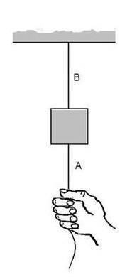

So if I slowly pull the A string first B string will tear apart... Cause the A string will expand and it will pull the mass and B string... So B string will reach its breaking weight before A... Cause B has an additional weight mg working on it..
But if I suddenly pull the A string,it will tear apart but the B string will remain intact... I am trying to understand why this happens... I mean what is the exact mechanism here?
Applying Newton's second law to the block we have
Fnet = ma
FA - FB + mg = ma
FA - FB = m(a-g).
If you pull it slowly, acceleration a is negligible and we get
FA - FB = -mg < 0
FA < FB
FB is larger.
But if you pull very fast than a is very large and we get
FA - FB = m(a-g) >0
FA > FB
FA is larger.
Likes 1 person
Thank you... :)
