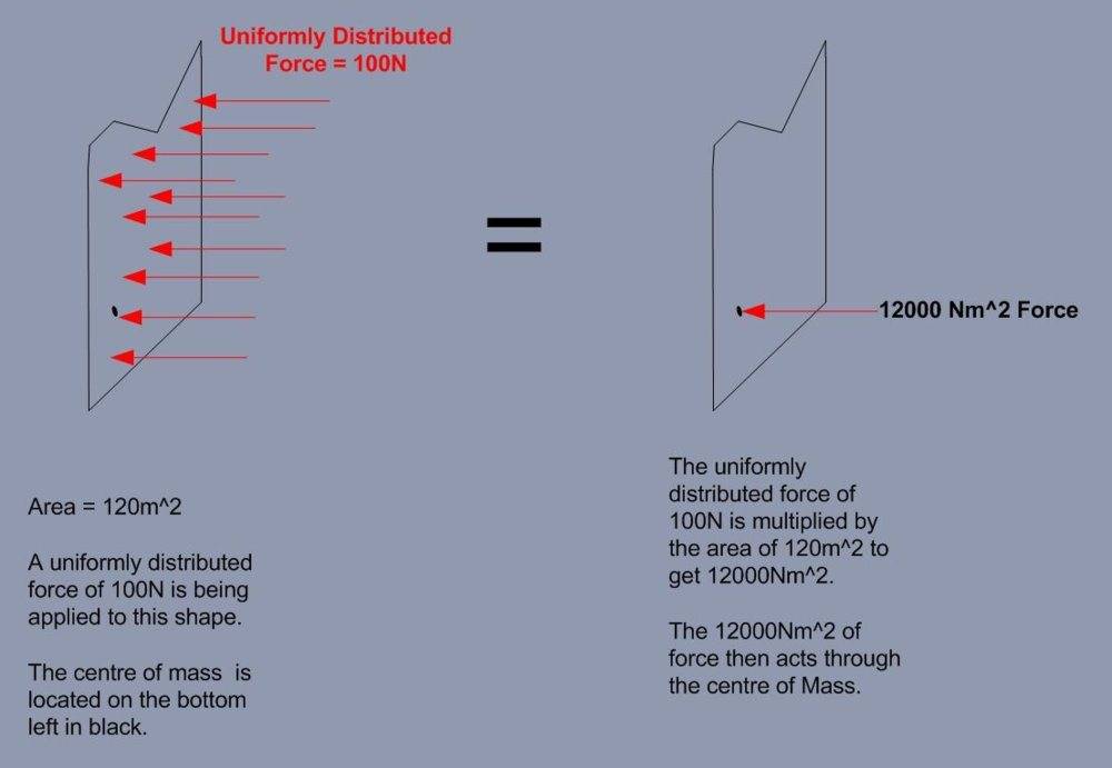

If I had an oddly shaped object for which I found the centre of mass and its surface area.
I then applied a uniformly distributed force of 100N on that object's surface, then would I be correct in saying that the uniformly distributed force of 100N is converted to an equivalent point force by multiplying the area by the force. The equivalent point force then acts through the objects centre of mass.
Below is a picture of what I am trying to understand:-
Would this illustration be correct?
Thank you.

Nearly right, but if a 100N force is uniformly distributed over an area then that gives a pressure: force per unit area. 100/1200 N/m2 in this case. So equating that to a point force by multiplying back again by the area gives you 100N again, as is required for it be a force, not Nm2.

No, you are missing the main point of my post.
You started with a force, 100N. You said this was uniformly distributed over an area of 1200m2. That means you have a pressure of 100/1200 N/m2.
You can multiply the pressure by the area to get back to 100N to find the equivalent point force, but it makes no sense to multiply a force by an area, and it certainly does not give a force as an answer.

If the force is uniformly distributed over an area, the equivalent point force would be at the geometric center of the area. This does not necessarily correspond to the center of mass of the object.

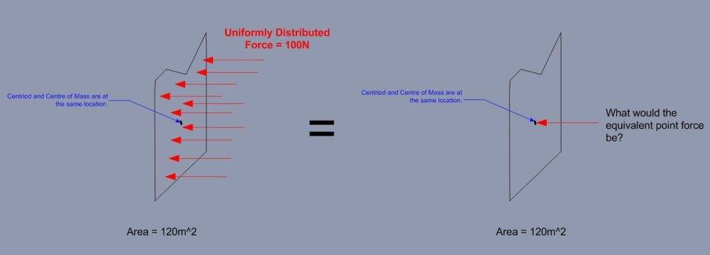

Hi Haruspex
I think I'm more confused then I was to start with, I have made things more confusing myself so my apologies.
If I can step back a moment; I am trying to determine the method to convert a uniformly distributed force being applied over a shapes surface area into an equivalent point force that acts through the centre of mass and the centroid (where centre of mass and centroid are the same point).
I have amended my diagram to look like:-
Is there a method of converting a uniformly distributed force of 100N being applied to a surface area 0f 120m^2 into an equivalent point force that acts through the centre of mass and the centroid?
This is what I am trying to determine.

A uniformly applied force will be equivalent to a single force applied at the plate's centroid, regardless of where the mass centre is.
If the total distributed force is 100N then the equivalent point force is 100N. There is nothing to be gained by first dividing by the plate's area to obtain a pressure then multiplying by it again to obtain the magnitude of the point force.
In your original post you confused force with pressure. Because the force is spread uniformly you reasonably thought of it as being a pressure, but failed to realize that to evaluate the pressure you need to divide the total force by the area.
Similarly, if the plate has a uniform mass distribution then its mass centre will be at the plate's centroid regardless of how the force is distributed. The force distribution will have its own centroid.

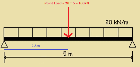

If the total distributed force is 100N then the equivalent point force is 100N. – The reason why I multiplied it by the surface area is because when working out reaction forces for beams; to convert a uniformly distributed load for a simply supported beam I must multiply the distributed load by the area or span the load covers for example: -
As you can see I have multiplied the load of 20kN/m by 5m to get 100kN, and this point load acts at the beams ½ way point which I thought was always the centre of mass but now I know that the point load actually acts on the centroid. I was trying to take the above example and apply it to a surface area. So why in this case would you multiply the load by the span but in my plate example you would not multiply the distributed load by the area?

Uniform distribution of the force is a relationship between the force and the region over which it is distributed. It is independent of the mass distribution over the region.
For each (force and mass) independently, if the distribution is uniform then average location is at the centroid of the region.
A continuously distributed force can be described as exerting a pressure which is a function of position, ##P(\vec x)## at point ##\vec x##, say. The total force is the integral over the area, ∫P.dA, where dA is an element of area. (dA is also a vector, but I don't want to complicate matters.)
If the force is uniform then P is constant and can be factored out: ##F=P\int.dA##. But ∫.dA is just the total area, A.
To find the effective location of the force, ##\bar x## (its average position) we write ##F.\bar x=\int P(\vec x).\vec x.dA##. (This is a "balance of moments" equation.). Again, with P constant we factor it out to produce ##F.\bar x=P\int \vec x.dA##.
By definition, ##\frac{\int \vec x.dA}{\int .dA}## is the location of the centroid of the area, so we deduce ##\bar x## is the centroid.
We can perform exactly the same calculation in respect of a uniform mass distribution.
Yes, but note that the load is specified as a force per unit length (kN/m), not as a force. So to find the total force you needed to multiply by the length.
If the force is over an area then it may be specified as a force per unit area, i.e. a pressure, maybe kN/m2. So in your post #1 you would have it as (100/1200)N/m2. Again, to find the total force you would multiply that by the area; but since you stated the total force there was no need to do the division and multiplication; that would be wasted efffort.

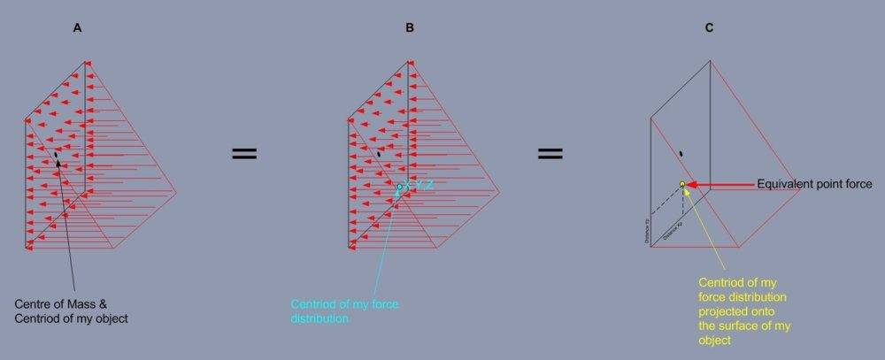

Something has hit home regarding your comment about the centriod of a force distribution.
After some head scratching I was hoping I could get your opinion on the following:-
In Diagram A have a non uniform force that is being applied to my shape.
The centre of mass & centroid are the same location as the density of the material is uniform.
In Diagram B I have calculated the X,Y,Z position of the force distribution shown in blue.
I now have 2 x centroids, one for my shape and one for my force distribution.
In Diagram C I have projected the centroid of my force distribution onto my shape shown in yellow.
If I converted my non uniform distributed load into an equivalent point load then would it be correct to say that the point force would act at the projected centroid (yellow) and not the centroid of my shape.
Is this correct?

you've got it!
