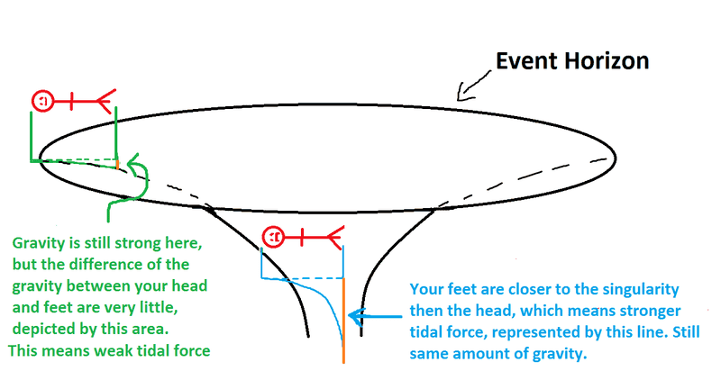

Maybe a picture will clear things up :)
Edit: Just to be clear, gravity does get stronger as you approach the center,
It's just the escape velocity at the event horizon IS the speed of light. So as you approach the singularity, the escape velocity just gets more and more then the speed of light.
Tidal force is what I'm depicting in the picture here, and is the reason why you don't notice much until you get close to the singularity.
http://[ATTACH=full]199794[/ATTACH] [ATTACH=full]199795[/ATTACH]

  • #35
rrogers said:
Think slope and height: You can have a steep slope (cliff) or a gentle one; height governs the potential energy involved.
This viewpoint only works outside the horizon. At and inside the horizon, the concept of "gravitational potential energy" is not well-defined; there is no "cliff" to have a slope or a height in your analogy.
Again, this viewpoint only works outside the horizon. At and inside the horizon, there are no static observers, and "gravity" in the sense you're using it here is only well-defined relative to static observers.
Same comment here: "escape velocity" is only well-defined relative to static observers, and there aren't any at or inside the horizon.
Again, this depiction is only valid outside the horizon. At and inside the horizon, there is no way to draw a picture of "space", because that would require spacetime to be static, and spacetime is not static at or inside the horizon.
