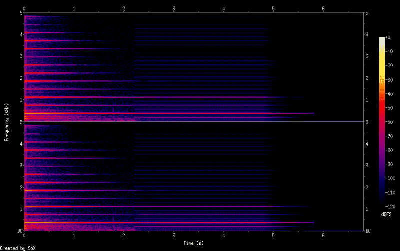

The overtones are always there. The difference is that you are essentially removing the fundamental frequency. If you look at the spectrogram of a plucked string, you will see that the lower frequencies are sustained for much longer, with the fundamental frequency displaying the slowest decay. Again, you can even see it in the video, as the higher frequencies die out, the string takes the shape of the fundamental frequency.
When using finger tip to remove the fundamental frequency, my impression is that the duration of the sustained overtone is only somewhat less than the duration of a string with fundamental frequency, depending on the overtone. Higher overtones do decay a bit quicker, as quadruple frequency decays quicker than double frequency. Example starting at 3:15 into this video with a spectrum analyzer. The first snippet is the fundamental frequency, the next snippet is double frequency, and the next is triple frequency.
Here is the spectrogram of an acoustic guitar:
It should be rather clear that the higher overtones decay quicker than the lower and the fundamental frequency. One should also remember that the actual guitar string (or the string of any actual instrument) is really not an ideal damped string.
