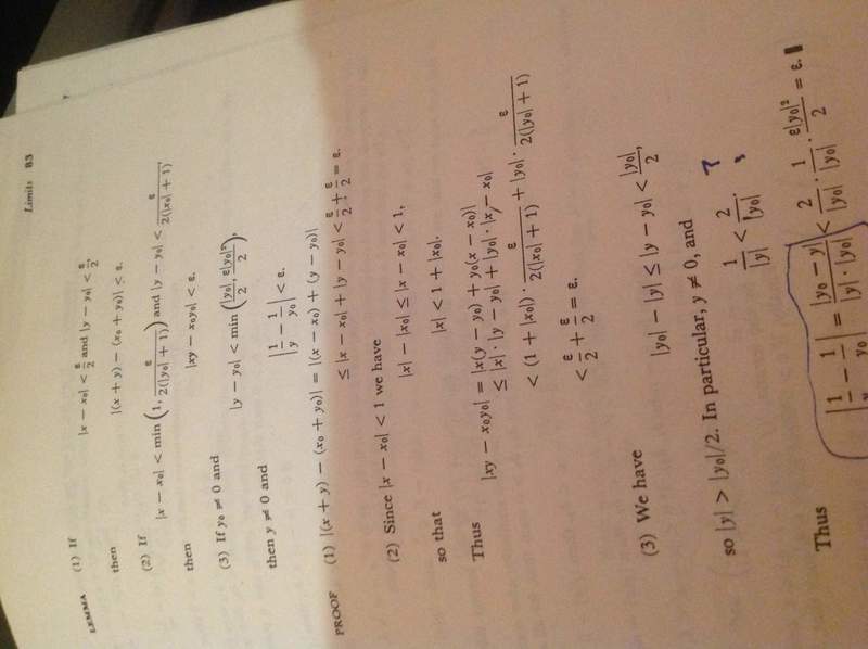

I'm still a math newbie. I'm just about finished with part 1 of Spivak's calculus; this is my first experience with more advanced math / deeper understanding (in high school and college I did well in calculus because I could memorize to perform operations, but I never had to understand why the formulas were the way they were; no proofs were mentioned).
Anyway, in doing some of Spivak's proofs, I am 1) Understanding and memorizing the results...for instance, I am rembering if g is continuous at a, and f is continuous at g of a, then f(g(a)) is continuous 2) Most of the results are intuitive to me 3) I am understanding the proofs as I go through them...I am able to logically understand all that he is saying.
What I am not able to do, however, is memorize or recreate all the proofs. Some of them are very long and complicated and frankly I don't know how anybody came up with them in the first place. Especially the proof of why a function can't have to limits; the lemma he provides + the proof derived from the lemma are 2 pages of incredibly confusing work arounds to get to the results. And this is only part 1 of spivaks calculus...im sure this stuff is a cake walk for most math majors and it will only get harder from here on out.
So my question is, do you math guys all remember/can recreate most proofs? I am not talking about proving something like the triangle inequality, I'm talking about the really complex ones. Is having an intuitive understanding, remembering the outcomes, and following the proofs when I go through them enough?
Eventually you should be able to figure all of those proofs out on your own, but that is probably a bit much to be asking on a first pass through the material. If you can do most of the exercises and have a good intuitive understanding of things, then that should be fine for now. As you get more comfortable with the ideas, the trickier proofs should come to you, but it's okay if they seem elusive at the moment.
I think eventually I will be able to do them all on my own.
but I have no idea how, when asked to prove that a function cannot have two limits at one point, I am supposed to bust out this:
That lemma is unnecessary to show that limits are unique. Instead it is used to establish rules for computing limits of sums, products, and quotients of functions.
Edit: As to how you would figure out the proof for that lemma anyway, the basic idea is that you write out the desired estimate and then work backwards to figure out what works.

I agree. Just not sure how anybody would be able to recreate a proof requiring a lemma that was specifically created for that proof.
Mathematics doesn't get invented in the same order that it gets published (either in papers or textbooks). If you want to find a proof of something, you start with the big ideas and then fill in the details. That's what other posts mean by "learning" a proof - i.e. learning how the the big ideas fit together. if you know that, you can work out the details without having to memorize everything.
if some of the "details" need a long (but maybe straightforward) proof, you split them off as a separate theorem. A "lemma" is just another name for a "theorem that you only use a few times, to prove something else".
