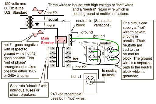

see if this thread is any help
https://www.physicsforums.com/threads/total-amperage-in-a-service-panel.705961/
Drakkith posted a great illustration in post #2
proxy.php?image=http%3A%2F%2Fhyperphysics.phy-astr.gsu.edu%2Fhbase%2Felectric%2Fimgele%2Fhse.gif
it's a long thread with lots of questions and answers
here's a shorter article that's probably the source of that picture
http://hyperphysics.phy-astr.gsu.edu/hbase/electric/hsehld.html
Likes PietKuip and physics user1
That could be fine if the OP is in the US. It will cause a mental breakdown if the OP lives in Europe. :))
