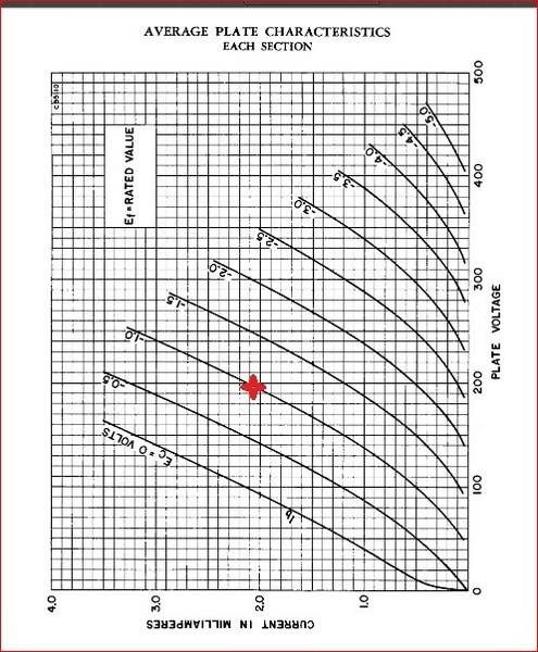

U3b ? i see 215 volts across 100k cathode resistor so voltage across the tube is 416-215 = 201 v at 2.15 ma,
okay per this curve ?
http://www.drtube.com/datasheets/12ax7-sylvania1955.pdf page 3 of 4

So I am asking having 415VDC from plate to ground is OK on V3b? I measured 416VDC from plate to ground and the schematic indicates 415VDC. If so what does the 300V max plate voltage on the data sheet under ratings Indicate? I assume one can and often does exceed the max.
The max plate dissipation is 1 watt and a typical plate current would be 1.2 mA. with a plate voltage of 415 V the plate current would be 1/415=2.4mA X 70% = 1.7mA. Most likely anything around 3mA would red plate the tube if not less.
So...I ASSUME the plate voltage is not so important as long as the cathode resistor keeps the current flowing through the tube within a certain range. I also ASSUME there must be some max plate voltage that will cause the tube to arc. One may get away with a certain level of increased plate voltage but you will not exceed the max current flow for long
NOTE: Plate voltage does have an effect on the sound and headroom...so I understand why Mesa would want higher plate voltage...I just wonder how close to the limit of a 12AX7 they are and what is the effect on tube life.
Also I made a mistake V3 is not the inverter tube, it is a preamp tube in the lead channel.
I don't often see these high voltages on 12AX7 preamp tubes. I assume it is being done in this way in this amp to cut cost as I can think of other ways to produce high gain preamp circuits with a lot less stress on the tubes.
Billy
EDIT: I understand now. The voltage is referenced plate to cathode not to ground as would be the case with a grid bias tube.
I knew you'd figure that out ...
look at the datasheet
there's limits on heater to cathode voltage too. I never thought about that before, i suppose heater positive would steal cathode current away from plate ?
yes, note that the cathode is lifted above gnd by that 100k resistor

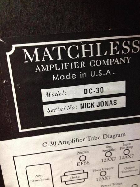

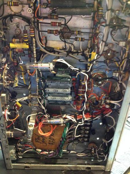

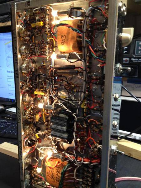

Photos I took of a custom DC 30 I repaired a few days ago.
Cost was not an issue with this amp. A standard Matchless DC 30 cost in excess of $4000 dollars. This one was not standard and I have no idea what it cost. The clean channel used 12AX7 preamp tubes. The lead channel used the EF86.
The above amp is an example of an amp used in a true commercial environment. As costly as it may be, there in fact three on hand. The cost represents on a very small fraction of the equipment used to produce a concert. The mixing board used for this band for example cost in excess of $250,000, The cost to put on a show in today's world is in the millions.
Planobilly said:
Matchless DC 30
http://www.matchlessamplifiers.com/amps/30-watt-and-over/c-30/

@Planobilly
Love those photos. The resistors actually have readable color codes! The Chinese ones these days make me think I'm going color blind.
Hi Tom,
I assume Phil the designer got them new from the normal supply chain. Everything in the amp was well done. Carbon Comp resistors...not sure why anyone would use them in today's world. They are great if you like noise...lol
Well..I guess if you are important enough to have your name as the serial number on a amp then....The good news is that Nick Jonas is a super nice kid who has not let his fame go to his head. He always says "thank you" and "yes sir" and is super nice to work with.
