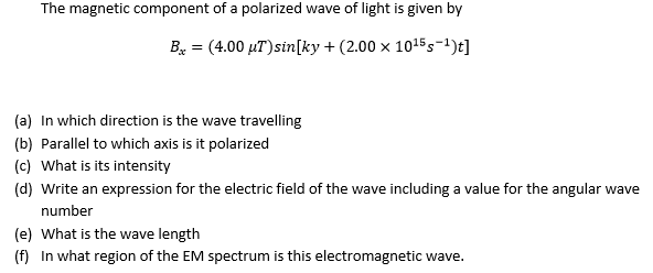

I am having problems completing the following questions:
a) The answer is apparently in the -y direction (I understand that the direction of propagation is the cross product of the electric and magnetic field that must be perpendicular to each other). I am not sure how to come to this conclusion.
I am not exactly sure what direction the magnetic component is. It is denoted Bx and is in the general form of a sinusoidal wave [A sin (wt+phi)] meaning that the phase shift must be ky, where k = 2pi/λ (so k is the 'wave-number') and y is the current direction along the y-axis. The angular frequency is simply equal to 2*10^15s and the peak amplitude is 4uT.
I would assume seeing as it is denoted as Bx the magnetic field will be in the positive x direction. As it is dependent on the y-position can it be stated that the electric field is in the y direction? I am not sure how the conclusion was drawn that it is propagating in the -y direction ie B cross E is = -y
b) Seeing as it is known that B is along the x-axis and the wave is propagating along the negative y-axis it must be polarized along the z axis (as x cross z = -y which makes sense)

d) General form of E
E = Eo sin (kx + wt)
Assume that the angular frequency should be equal so that wt = 2*10^-15t. The angular wave number, k, is equal to 2pi/λ. I would assume it is equal in magnitude to the magnetic field but in the x direction.
so E = Eo sin (kx + 2*10^15t)
Not sure how Eo is determined, maybe Maxwell's equations?
e) For light, f = 2*10^15/2pi, v = c so
λ = c/f = 94.247 um
Sit at y = 0, t=0 so that ##B_x = 0## and take a time step ##\Delta t##. Where do you have to go to be at the point where ##B_x = 0## again ?
So far the exercise only has mentioned a B field !
The direction of the magnetic field is not clear. Merely calling it Bx does not make it a vector in the x-direction. You have to give a unit vector in the appropriate direction. Once that is specified, the magnetic field is in that direction.
The ky in the oscillatory part states that the propagation is in the y direction. Whether it is +y or -y is decided by the answer to BvU's question above. Once that is decided, the direction of the electric field can be given following Maxwell.
I think the OP can safely assume the exercise is about a ##\vec B## field in the x-direction.
Can you get E0 from the intensity?
