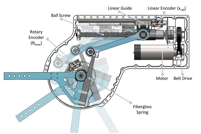

Here's one example for a knee exoskeleton:

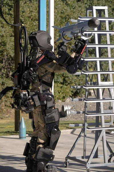

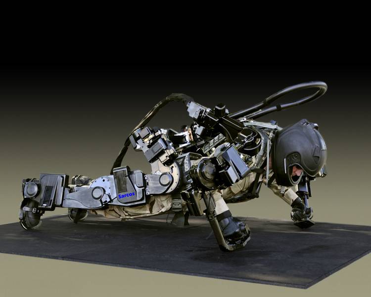

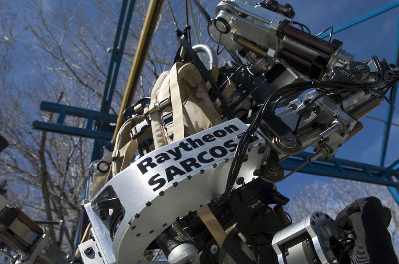

It looks to me like the SARCOS using is a combination of linear drive pivots and belt/cable pull drives. You can see evidence of these in the knee, hip, shoulder, elbow, and forearm rotation joints. It's kind of an interesting exercise trying to figure out what drives each joint in the unit.
Couple of pictures:
