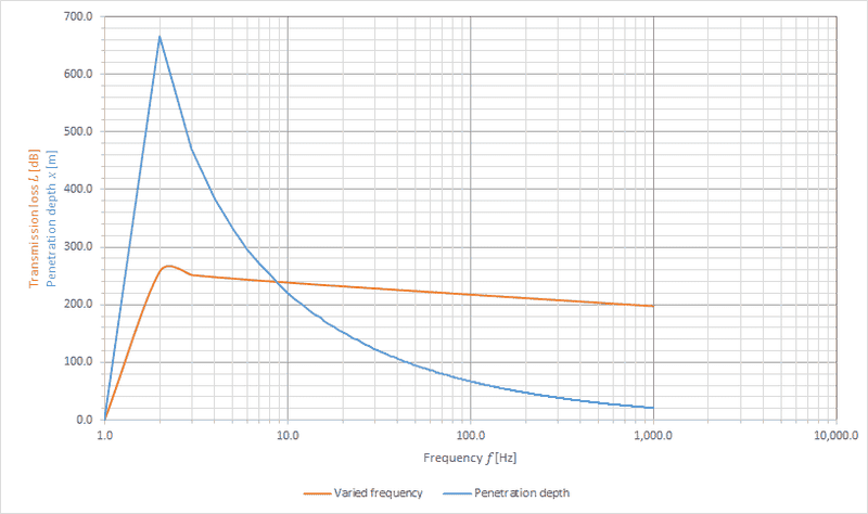

Depth of penetration
If we define depth of penetration as ##x\equiv1/\alpha##, where ##\alpha = \sqrt{\pi\mu\sigma f}## is the attenuation, so
\begin{equation}\begin{split}x&=\frac{1}{\sqrt{\pi\mu\sigma f}}\\&=\frac{1}{\sqrt{\pi\mu_0}}\cdot\frac{1}{\sqrt{\mu_r\sigma f}}\\&=892.0621\frac{1}{\sqrt{\mu_r\sigma f}}.\end{split}\end{equation}
Now, "for all practical purposes the relative permeability of salt water is 1," (Herring, 2007) so:
\begin{equation}\boxed{x=892.0621\frac{1}{\sqrt{\sigma f}}}.\end{equation}
The above is a simulation (using Excel) of the model, showing the penetration depth and absolute transmission loss as a function of frequency. Here we witness the penetration depth holding true to our expectations—if perhaps a little more extreme than expected—and the transmission loss showing the *opposite* of what the penetration depth shows.

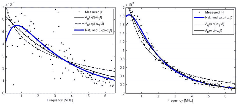

Zoksimovski (2012) semi-empirical model
I did find a good experimental report, Underwater Electromagnetic Communications Using
Conduction – Channel Characterization (Zoksimovski et. al., 2012), which detailed three separate approximate models for radio wave attenuation using a channel transfer function ##H##, outlining two far-field approximations:
\begin{equation}|H| = A_0 e^{-\alpha_1\sqrt{f}} \ \ \ \ \ \ \ (1)\end{equation}
\begin{equation}|H| = A_0 e^{-\alpha_2 f} \ \ \ \ \ \ \ \ \ (2)\end{equation}
and a near-field approximation:
\begin{equation} \boxed{|H| = \frac{p_1f^2 + p_2f + p_3}{q_1f^2 + q_2f + q_3}\,e^{-\alpha_3 f}}.\end{equation}
I'm interested more-so in the near field due to the high observed attenuation of radio waves in seawater. The data provided by Zoksimovski et. al. was unclear at best, but averages were found to be ##p_1 = 0.75\times 10^{-5}##, ##p_2 = 2.30\times 10^{-4}##, ##p_3 = 17.25\times 10^{-5}##, ##q_1 = 0.30##, ##q_2 = 0.15##, ##q_3 = 0.18##, ##\alpha_3 = 0.55##. These were the values used in the following simulation.
As you can see this model produces *tiny* received signals which are killed off within 10 Hz. I know this to not be physically accurate. It also does not factor the distance between antenna anywhere into calculations.
This is the graphs produced by Zoksimovski et. al. which do not show the same trends as my simulation (see the thick blue lines for the model discussed.) Perhaps this is an error in my simulation, however intuition suggests that the low values of the parameters will influence the trend in the way I've simulated.
