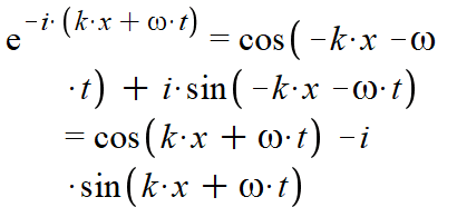

One thing I've noticed, is that if you use euler's formula on both of these expressions, and then use the even and oddness of the cosine and sine functions you get:
and
Which have the same real part but different imaginary parts. Often times the real part of the wave is the only part that we care about, in which case the conventional method and "my" method actually agree. However, if I am not mistaken the imaginary part of the expression actually carries information about the phase of the wave, so may indicate that there's only a phase difference between the 2 expressions. That said, since they are both trying to describe the same wave, they should have the same phase.

Consider the phase [itex]\theta_0[/itex] at a given [itex] (x_0,t_0) [/itex]. ([itex] k>0, \omega >0 [/itex])
To keep the same phase [and, thus, disturbance from equilibrium] with [itex]\theta_0= ( kx-\omega t)[/itex],
as t increases, what must [itex] x [/itex] do to keep the same phase?
Try again with [itex] (kx+\omega t)[/itex].
Likes etotheipi and BvU

Ok,
for ## ( kx - \omega t ) = \theta_0 ##
the x as a function of t will be ## \frac { \omega t + \theta_0} {k} ## so as time goes up x will increase at a rate of ## \frac \omega k ## which means x will move in the positive direction. As for ## ( kx + \omega t ) = \theta_0 ## , x as a function of t will be ## \frac {- \omega t + \theta_0} {k} ## so as t increases x will change at a rate of ## \frac {-\omega} k ## meaning it will be going backwards. So that all makes sense, and I can see why the conventional description works.
If I try the same thing on the other form by taking the propagation vector k to be in the ##- \hat x## direction i get ## ## ## ( -kx - \omega t ) = \theta_0 ## then x as a function of t will be ##- \frac {\omega t + \theta_0} {k} ## this form also has x decrease as t increases, showing it will travel backwards, and it seems it will also travel backwards at the same rate as the other form. That said there seems to be a phase difference, which coincidentally confirmed what I suspected looking at euler's formulas. Why would there be this phase difference?

The argument in the sinusoid has to be a scalar, but we know that the dot product of 2 vectors ( in this case the propagation vector and position vector) returns a scalar. So can't the scalar value that is the argument of the sinusoid be vector dependent? For example one of the recent things I've read to try and gain insight on my own is: http://www.physics.usu.edu/riffe/3750/Lecture 18.pdf , which describes a 3D wave as ## Ae^{i( \vec k \cdot \vec r - \omega t)} ## So ## \vec r ## is an arbitrary position in space that we want to look at, but ## \vec k ## is the wave specific vector quantity indicating the wavenumber, ## |\vec k | ##, and propagation direction, ## \hat k## . And since if were talking about 2 waves that only differ by direction, shouldn't one wave be ## Ae^{ i(|\vec k| \hat k \cdot \vec r - \omega t) } ## and the other wave be ## Ae^{ i(|\vec k| -\hat k \cdot \vec r - \omega t ) } ## Which if we define the axis these 2 waves to be traveling on as the x-axis, we get ## \hat k = \hat x ## for the wave traveling in the positive x, and ## \hat k = - \hat x ## for the wave traveling in the negative x direction. Resulting in the 2 waves ## Ae^{ i(|\vec k| \cdot x - \omega t} )## and ## Ae^{ i(-|\vec k| \cdot x - \omega t )} ##
You have answered your own question. When we write ##\sin(kx-\omega t)## the "##k##" in the expression is a magnitude as in ##k=\dfrac{2\pi}{\lambda}## and so is ##x##. You should view ##kx## as the result of having taken the dot product. For aesthetic reasons we arrange the phase so that ##kx## appears always positive in the argument of the sinusoid.

2. Wave traveling in the - x direction, i.e. ##\vec k \cdot \vec x=-kx##
(a) ##\sin(\vec k \cdot \vec x-\omega t)=\sin(-kx-\omega t)=-\sin(kx+\omega t)##
(b) ##\cos(\vec k \cdot \vec x-\omega t)=\cos(-kx-\omega t)=\cos(kx+\omega t)##
Do you see the pattern and how the phase determines the direction of propagation?
