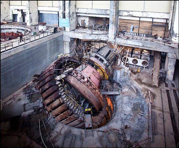

The forces involved can be quite high. Many years ago a co-worker claimed to have witnessed a large turbine generator being connected to the grid without being properly synchronized. He said the stator ripped right out if its foundation as it tried to rotate due to being out of phase. Pretty amazing, if you have ever seen one of these machines -- they are big and heavy (in a 1000 MW generator, the stator alone is 500 tons) with massive foundations.
  • Wow
Likes Jimster41, Chandrakanth_balusa, russ_watters and 2 others

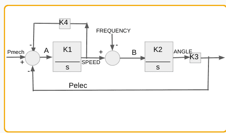

For the benefit of the OP as well as others, the following is a linearized model that we use for power system analysis. The principle linearization is around speed. The model is good for small perturbations around nominal speed.
Where:
Pmech= per unit mechanical power (1.0=rated)
Pelect= per unit electrical power (1.0=rated)
SPEED=per unit speed (the linearization process converts kinetic energy to speed, hence the factor 2 in constant K1)
ANGLE=rotor angle in radians
FREQUENCY= per unit grid frequency (1.0=nominal)
K1= constant = 1/2H where H is the per unit moment of inertia of turbine+generator. Typical value for H is 4.
K2= 377 radians/sec for 60 Hz, or 314 radians/sec for 50 Hz.
K3= a constant proportional to the strength of the transmission ties to the grid. There is no typical value for this. Opening the circuit breaker is like setting K3=0.
K4= a constant proportional to friction and windage of the rotating machines. Typically, 0.03
Expressing everything in per unit, is customary in the power industry.
The block diagram, and the 1/s notation for integration should be familiar to those who studied differential equations, and Laplace transforms. But even if you do not know those things, only two things are significant. They are:
  1. This block diagram is well known. It represents a damped oscillator. Damping for a typical power plant is very small.
  2. In the steady state, by definition, nothing changes. In that case, the points labeled A and B on the diagram must both be zero. That means Pmech-friction=Pelect, and SPEED=FREQUENCY.
That brings us back to the OP question, which was why does SPEED=FREQUENCY?
http://archive.boston.com/bigpicture/2009/09/the_sayanoshushenskaya_dam_acc.html
  • Wow
