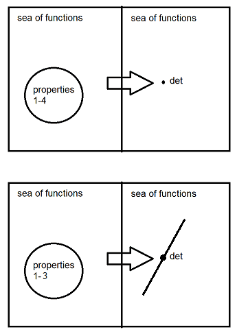

It says that any function ##f## with the properties 1-4 is automatically ##f=\det ##. There is no second function that does that, hence the determinant is unique among all functions that satisfy 1-4.
If we have only 1-3, then we get uniqueness up to a constant factor, namely ##f(I_1,\ldots,I_n).##
It is a typical theorem that connects a specific function (here the determinant) with an at prior arbitrary function, that satisfies certain key properties. These properties are called functional equations. For the exponential function, it is ##e(x+y)=e(x)\cdot e(y)## and ##e(0)=1##, for the Gamma function, it is ##G(x+1)=x\cdot G(x)\, , \,G(1)=1## and logarithmic convexity. They all have some central properties which make them unique up to a constant multiple, and a certain point to fix this factor.
The theorem says that the pictures on the left with their abstract definition pattern function plus functional equations look actually like the pictures on the right: properties 1-4 yield a unique dot (= function) which is the determinant, and properties 1-3 yield a straight ##x\cdot \det## with the determinant on it.
