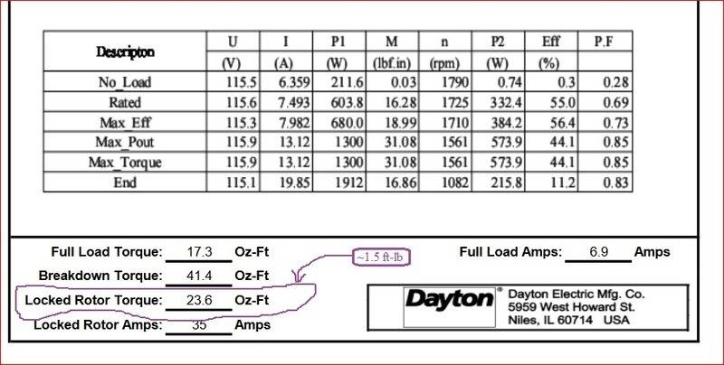

Your question needs to specify how much time is allowed to accelerate. If we ignore friction, and the torque/speed characteristics of the motor, then any tiny motor can accelerate the flywheel giving infinite time.
You also need to specify the type of motor. Many motors have very poor torque starting from a dead stop. Traction motors have very good starting torque.
Can you photograph the nameplate of the motor and upload it here?

I looked at the Dayton web page. I can't find the torque-speed curve.

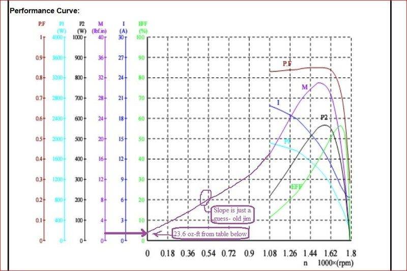

This purports to be the curves for your motor.
https://www.grainger.com/ec/pdf/6K778_16.pdf
purple line M is torque. I extended it on down to zero speed with Paint.
Observe torque starts out low at standstill , builds to a peak 20X greater, then drops off quickly as RPM moves into operating range.. That's how induction motors work.
Would another old-timer kindly check my physics? Been having senior moments of late.
Just like F = MA,
Torque = M(oment of Inertia) X A(cceleration in radians per second2)
Your desired final speed is almost 1800 RPM which is 1800 X 2π radians per second
to reach that in 10 seconds requires average acceleration of 180π rad/sec/sec.
Acceleration can start out somewhat slower and finish somewhat faster
but you need to pick a flywheel with a moment of inertia that your motor can accelerate into its higher torque range within just a few seconds . Else you'll waste all your 10 second start time with motor laboring at low speed.
Let us just pick a MOI to give half the requisite average acceleration at zero RPM.
Torque at zero speed = 1.5 ft⋅lbs

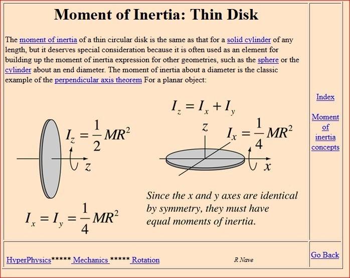

i'll guess your flywheel will be a thin disc like a grinding wheel
http://hyperphysics.phy-astr.gsu.edu/hbase/tdisc.html
I = ½MR2
Hmm you get to trade off diameter for mass.
Let's just pick a six inch diameter, half a foot, radius ¼ foot
0.005305 = ½MR2
0.005305 = ½M X ¼2
M = 0.005305 / (½ X ¼2) = 0.1698
NOTE : Since we expressed force in pounds , mass is in slugs
0.1698slugs X 32.174 lbf/slug (at 1g) = 5.46 pounds
so a small diameter flywheel can be pretty heavy. A bigger diameter will have to be lighter.

When you try this thing out, listen carefully to the motor.
You'll hear its rate of acceleration increase with speed as it walks up its speed-torque curve. It almost snaps over the peak.
Once you recognize that sound and relate it in your mind's eye to that curve, it helps you "feel" induction motor behavior.
Torque falls off as square of applied voltage. That's why long extension cords that drop voltage are so deadly to induction motors - they never make it to torque peak so current stays high , see the blue "I" curve up above. They'll burn up.
Okay that's induction motors in a nutshell.
I hope you get interested enough to do some predictive iterative calculations.
Calculate acceleration from standstill, new speed after one second,
insert new torque from curve for that speed, calculate new acceleration, new speed at end of that additional second,
insert that greater torque,
etc
If you curve fit that torque curve you could simulate startup with say 1/10 second intervals in a spreadsheet and play with flywheel weights and diameters. I loved to do that sort of thing in BASIC before Miscroshaft forced everybody from QBASIC into spreadsheets. I never went along.
