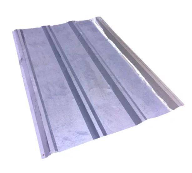

Given a gauge 25 (0.02" or 0.5mm) metal roof roll formed made from hot-dip galvanized cold rolled mild steel. How long can these thin metal roof melt in a typical house or office fire with typical fire load?
I read conflicting information. Some roof contractor said these thin gauge 25 metal sheet were so fireproof that during a fire, the firemen have to use saw to cut them to vent them. While other engineers say it has zero fire rating and can't last 2 minutes.
But if the metal sheet melting point is 1370°C (2500°F) and the fire tip is only 2500 degree Fahrenheit. Maybe it's that context where the fireman has to open it with saw to vent the fire?
In a typical fire with house or office items fire load. What temperature does it reach at the metal roof line?

The material is too thin and flexible to be relied upon to slow the spread of a fire. The material may need to be cut away by firefighters to gain access. Those are not contradictions.
It does not need to melt. The galvanising will burn off quickly to white zinc oxide, which is blown away. Then the iron sheet will glow red-hot and distort. The hot iron surface will be burned if it contacts oxygen remaining in the air, so material will be lost and the sheet will become thinner. Once burned, it cannot be reused.

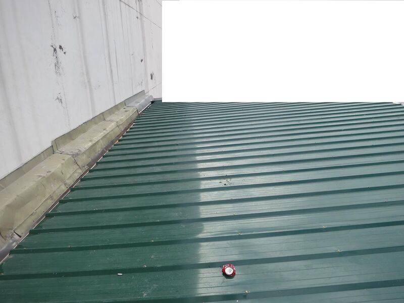

Ok. Here is my situation. My house is adjacent to a tall building with their columns part of their firewall. I also have a firewall. The city official just told me to put 39 inches parapet in the roofline.
But is it enough? If there was a fire below and it would breach the thin metal roof, then it can reach the adjacent building wall, is that right?
If it takes only minutes for the 0.02" thin metal roof to burn through. Then I will remove the roof and make it open it would become just aircon bay so no possibility of that occurring. Because if the fire occurred and there were damages. I may lose the entire house/building to them. This is the reason I need to know exactly how long thin metal roof can burn. The roof contractor who made it said it takes 2 hours, and thin metal roof are fireproof. But I don't believe him as he only wanted to sell roof. The architect and structural engineer said they didn't know too the behavior of thin metal roof in fire.

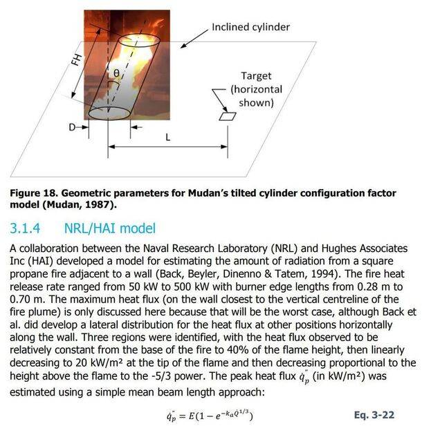

Let's assume the residential below the metal roof is full of stuff like bed, sofa, clothes, books, etc. that is part of a house. Based on the the following, what is heat flux of a typical residential with full things in the floor? What heat flux can burn a 0.02" thin metal roof in 10 minutes? If the heat flux matches that of typical residential. Then I have to make the decision to remove at least 13 feet of the metal roof from the boundary and make it open and use as aircon bay. I need to make the decision based on the computations because the architect, engineer don't know how compute for it (so they just ignore stuff like this and just believe the roof contractor that metal roof is fireproof).
from https://www.branz.co.nz/pubs/research-reports/sr409/
