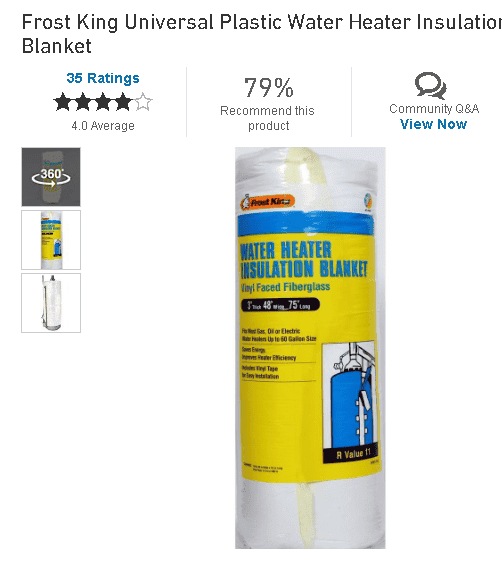

Analytically, it's a two part solution
80F and 50% RH is dewpoint of 59.7F
(per https://www.calculator.net/dew-poin...dewpointunit=fahrenheit&humidity=50&x=68&y=20 )
so you'll have condensation
and on account of 'heat of vaporization' of that water you're removing from the room air, faster warming until the tank wall reaches that temperature.
Afterward plain old convection takes over.
Being not a heat transfer guy, i know my limits...
So I think i'd wrap it with one of those water heater insulating blankets , install a thermometer and see what happens.

Tank insulation is far cheaper than a chiller. Tank insulation should have a vapor barrier on the outside to prevent condensation on the tank wall. The best tank insulation would be a closed cell spray foam because that is its own vapor barrier. Or just let the water warm to the dew point temperature quickly.
