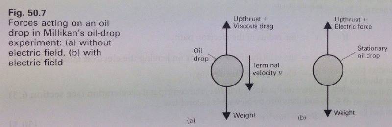

In that case I'm missing some force.
This is what I have my book:
From book:
No EF: Weight = Upthrust due to air + Viscous drag.
EF: Weight = Upthrust + Electric force.
So:
No EF: Viscous drag = 10-14 * 10 = 10-13 N.
EF: Q = m g / (V / d) = 10-13 / (1500 / 0.012) = 8 * 10-19 C.
So we have the answer Q = 8 * 10-19 C. I don't understand why we need all the other numbers given in the problem and why we need to calculate the no EF force.
In the book's figure the drop on the right hand side is stationary, so no air resistance force, just the electric force balancing the gravitational force.
In the present problem the oil drop is moving in both cases.
Likes moenste
Aaaah, it even says so.

Then 6.4 * 10-19 / 1.6 * 10-19 = 4, not 6 as in the answer. What's wrong? I recalculated everything and checked the book answer, it's 6. So, don't think that it's the calculation.
Friction always works against the direction of motion. You've added the friction force to the "Upthrust" and electric force, which is not correct. You might find it helpful to write out the force balance so that it sums to zero. Since this mysterious "Upthrust" is always zero, just drop it from your equation:
##F_E - Weight - F_2 = 0##
Where ##F_E## is the electric force.
Likes moenste
gneill said:
Okay, good so far!
Yes, I think I lost that moment. Air resistance is against motion. Since the drop is moving upwards, therefore the air resistance is directed downwards in pair with the weight.
So it's Q E = Weight + Air resistance.
Q E = 2 * 10-14 N + 10-13 N.
Q E = 1.2 * 10-13 N
Q = 1.2 * 10-13 / 125 000 = 9.6 * 10-19 Q.
Then 9.6 * 10-19 / 1.6 * 10-19 = 6.
