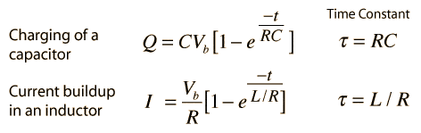

I don't understand this graph
How the capacitor will charge with series Resistance?
Hello,
I got
a. The rate of charging is typically described in terms of a time constant RC.
b. The electrical transient phenomena in capacitors and inductors are exponential processes
voltage across the capacitor
how we get exponential here?
The voltage on a capacitor is Vc = Q / C.
Note: you copied images from two different circuit explanations and that's causing confusion. The "Vb" in the first image is "Vs" in the second image.
Likes ENE
i have to learn this equation?
We solve the differential equation for the circuit. See for example
http://web.mit.edu/molly/Public/circuits-b.pdf
and scroll down to page W6-6. This uses Q as the variable, not V, but you can change variables using Q = CV if you prefer.
