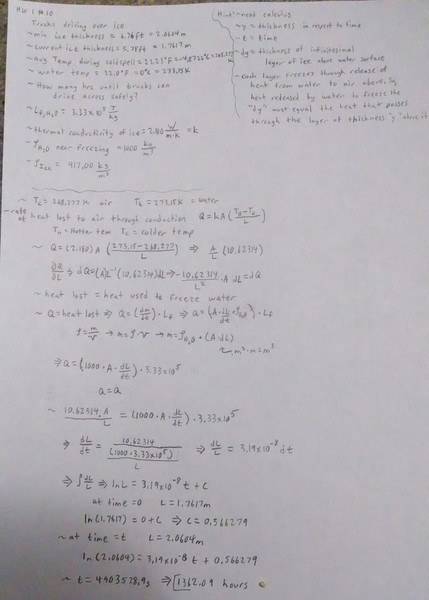

Sorbik
ice needs to be at least 6.76 feet thick. = 2.0604m
Currently the ice is 5.78 feet thick = 1.7617m
Later, there is a cold spell
If the average temperature during the cold spell is 23.23°F =-4.8722C = 268.277K
and the water temperature is 32.0°F = 0C = 273.15K
how many hours will it take for the frozen lake to be safely passable?
The latent heat of fusion of water is 3.33 × 105 J/kg
and the thermal conductivity of ice is 2.180 W/m·K.
The density of water near freezing is 1000.0 kg/m3 and the
density of ice is 917.00 kg/m3.
This problem involves calculus. Let y denote the thickness of the ice at any time t, with dy the thickness of an infinitesimal layer of ice that resides just above the water surface. Each layer freezes through the release of heat from the water to the air above. Therefore, the heat needed to be released by the water to freeze the infinitesimal layer dy must equal the heat that passes through the layer of thickness y above it.

In kelvin , T 1 = 23.23°F = 268.277 K
T2 = 32.0°F = 273.15 K
heat released to air = k * A * (T1- T2) / L = 2.180 * A * ( 273.15 - 268.277) /L = 10.623*A / L Watts.
we have dQ = -(10.623 / (L ^2)) dL .
heat lost = heat utilized for freezing
L is length of the ice ,
so, if Q = heat lost = (dm/dt)* latent heat of fusion of water = ( A* dL * density /dt ) * latent heat of fusion of water
Q = ( 1000*A* dL/dt) * 3.33 × 10^5
so, 10.623*A / L = ( 1000*A* dL/dt) * 3.33 × 10^5
dL/dt = (10.623/(1000* 3.33 × 10^5))/L
so, dL/L = 0.0000000319 * dt
integrating ln L = 0.0000000319 * t + constant.
At time t =0 , L = 5.78 feet = 1.7617 m
ln 1.7617 = 0.0000000319 * 0 + constant
constant = ln 1.7617 = 0.566279 .
so, ln L = 0.0000000319 * t + 0.566279
at time t, L = 6.76 feet = 2.06 m
so, ln 2.06 = 0.0000000319 * t + 0.566279
time , t = 4903528.69 seconds = 1362.09 hours = 56.7538 days .
It takes 1362.09 hours for the ice to become 6.76 feet thick and be safe for driving.

I would use y for the thickness (reserving L for Latent heat): dtime = Q/Power .
your conduction [ k * A * (T1- T2) / L = ... Watts] is Power, not Energy Q.
With your value for k, I get approximately 15 million seconds.
You make it very hard to follow by plugging in constants right from the start. Algebra is much clearer if you work entirely symbolically, only plugging in values at the end.
heat released to air = k * A * (T1- T2) / L, where L is length of ice
I guess you mean rate of release of heat (dQ/dt), L is depth of ice, and A is some arbitrary area.
we have dQ = -(k * A * (T1- T2) / (L ^2)) dL .

My calc understing is pretty poor. Lots of bad turns. I don't think this problem should have a ln(L) in it either after integrating or have the need to use indefinite integrals and solving for constants.
You're still messing with dQ/dL (or maybe it's (d/dL)(dQ/dt)). That does not mean anything useful.
You have, correctly, ##\dot Q = k A \Delta\theta / L## and ##\dot Q = \rho A \dot L \Lambda_f## (though you wrote Q instead of ##\dot Q## in each case), where Λf is the latent heat of fusion, and ρ is the density. Combine those two equations and solve the differential equation in L and t. You should not get any logarithmic terms.
your time is in the wrong place, because you confused Power conduction with Energy,
and you confused Energy for freezing with rate (you wrote dm/dt, instead of dm).

It looks like you pretty much knew what you were doing. You just made an algebraic error between the following two lines:
It should be LdL, not dL/L.
Otherwise, it looks correct.
Chet
Likes 1 person
Ok.
I have LdL = 3.19x10^-8*dt
∫LdL ==> L^2 / 2 = 3.19x10^-8 *t + C
at time = 0, L = 1.7617m
1.7617^2 / 2 = 0 + C ===> 1.55179 = C
at time = t, L = 2.0604m
2.0604^2 / 2 = 3.19x10^-8t + 1.55179
t = 17,894,377s ==> 4970.66 hours <-- time it takes to get another foot of ice ... 207.111 days?

Looks correct. That's a lot longer than winter, though. All that means is that the ice at this location will never get that thick (under present climate conditions).
