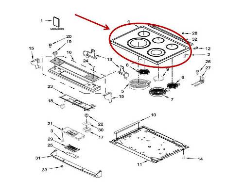

This is already done in our Cooktops (refer image below). They come with 4 Cook tops with Nichrome heating elements. So my question is, how many Nichrome Heating Elements can be connected in parallel in 110 V socket at home? Considering each Heating element is 600W, 800, 1200 and 2000W, which makes it 4600W. When turned on simultaneously. Can I connect 10 or 20 or 30 Heating elements of 1000 Watt each in parallel? Trying to understand what is the limit and how we know the limit of 110V or 230 V sockets available in house.
No, not even 10.
For 230 volts, the maximum current from one outlet can be about 10 amps. That is only 230 volts * 10 amps = 2.3 kW. You could only connect two 1 kW elements.
For a 230 volt, wired in stove without the plug and socket, the limit is about 35 amp = 230 volt * 35 amp = 8 kW, so it would run eight of your 1 kW elements.

I don't believe you have all 8 kW running from a single socket. The house is probably supplied from a single distribution board, that supplies a fixed stove and many other separately fused power outlets.

Look in your fuse box or breaker box. There is probably a large double-breaker at the top of the box that turns off all power. 50Amp and 100Amp are common values.
Multiply that Current rating by the Voltage. This is the maximum wattage you can draw before this main breaker trips.
Now look at the individual breakers in the panel.
Add up the the Amp rating that is on each of them.
Multiply the total Amps by the line Voltage, this will tell you the maximum Watts your house is wired for.
The answer to your question of how many Watts you can draw is the lower of the two answers from the above multiplies.

In the USA the standard is 20 amp circuits for countertop/kitchen 120 volt receptacles. Most others in the house will be 15 amps. Since you seem to be familiar with the relationship between volts, amps, and watts you should be able to answer this question on your own. The cooktop you refer to is likely fed by a 240 volt 40 or perhaps 50 amp circuit if it is a unit with an oven as well. Maybe smaller if just a cooktop. Do the math....
