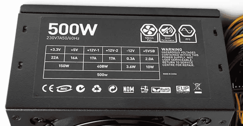

you didn't read the response given to you on page 1 of the thread
eg. A 600W PC PSU is the total rating
NOT the rating of anyone of the DC rails ... 3.3V, 5V, 12V etc
Usually the 5V and the 3.3V rails have the highest current capabilities the +12V somewhat lower and the -12V very low current capability
lets look at an example ...
OK on this particular one, you can see that it has 2 x +12V outputs, each one capable of 17A
so there is your max and you DO NOT want to run at that max of 17A each ... it will shorten the life of the PSU
So you could run 2 x 12V / 15A peltiers, one on each line
Get a higher rated PSU and you may be able to get a second peltier on each 12V rail

see my previous comments in this post ... that 600W is the total capability of a particular PC PSU :smile:
If @HomeExperiement really need many high current peltier units and not just a couple then he needs to look at a
specific 230AC-12VDC PSU that is capable of supplying the needed currentDave
