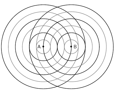

In summary: The distances between each concentric circle is the wavelenght isn't it? which for sound, I guess it's the dist btw each compression. So each ring is a compression, and each space is a rarefraction. Can you confirm if this is right?Yes.

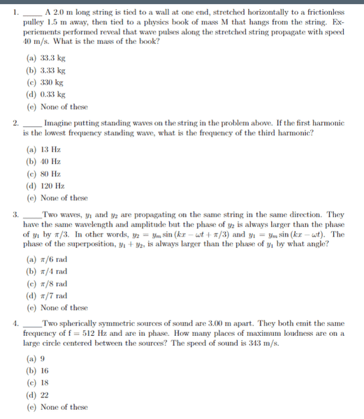

the last problem on this page:
##v= \lambda f##
I'm guessing I'm looking for the maximum amplitude in a overlapping wavefront diagram like this?
v=343m/s
\\f=512Hz
\\343/512=\lambda=0.67m
\\3/0.67=4.5m
So 4.5 wavelengths will fit between the two sources. I'm not sure where to go from here.
Can you relate the question to double slit interference?

Have you studied interference from two point sources? Does the formula ##d \sin \theta = n \lambda## look familiar?

I think it means to draw a circle centered half way between the sources, in a plane containing them, and passing outside both sources. Count the local maxima on that. With that interpretation I get an answer matching one offered.
Hmm. I get one of the answers also if I assume that the center of the circle is halfway between the sources, but the radius of the circle is much greater than the distance between the sources. Making the radius much greater than the distance between the sources allows for the approximation that yields ##d \sin \theta = n \lambda##.

I'm having trouble with finding the local maxima, what exactly do I count?
##d## is the distance between the two sources
##\theta## is an angle specifying the direction from the center of the circle to a point on the circle at which you would get constructive interference if the radius of the circle is large. ##\,\,\,\theta = 0## corresponds to the direction along the perpendicular bisector of the line connecting the two sources.
##n## is an integer 0, 1, 2, 3, ... corresponding to the different directions for constructive interference.
But, if you have not covered this formula, then I don't think you would be expected to derive it on your own just to answer the question. Here is a link that provides more information: http://webassign.net/question_assets/buelemphys1/chapter25/section25dash1.pdf

A local maximum occurs where the two signals are in phase. You are told they start in phase. If they arrive in phase at some point, what can you say about the distances from that point to the sources?

True. The answer is independent of the size of the circle as long as the circle has a diameter greater than or equal to the distance between the sources. (The circle need not be centered on the sources. Any circle that encloses the two sources would have the same number of maxima.)
Edit: actually it might be the amplitude; wavelength is one cycle of oscillation compression and decompression.
Yes.
Suppose P is some point on the "large circle". Let ##d_1## and ##d_2## be the distances from the two sources to point P. Do you know the relation between ##d_1## and ##d_2## in order for constructive interference to occur at P?
D1 equal to D2.

This condition would indeed give you constructive interference. But there are other possibilities.

You can draw concentric circles that are centred on the sources and have radii which are whole numbers of wavelengths, but I consider that unhelpful in approaching this question.
Please try to answer the question I asked. If constructive interference occurs at a point which is d1 from one source and d2 from the other source what is the relationship between d1, d2 and the wavelength λ? (Hint: d1 and d2 themselves do not need to be whole numbers of wavelengths.)
