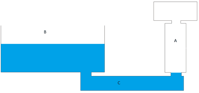

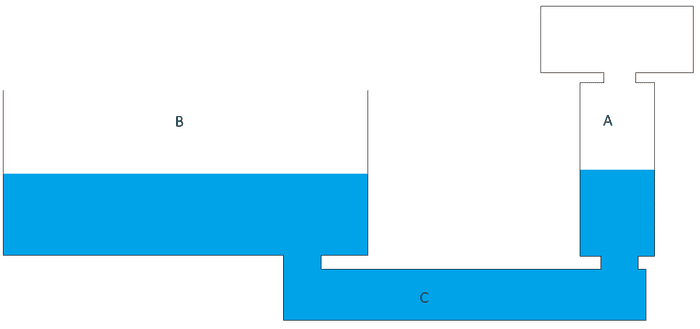

Given the following situation:
Given that A is air tight how would one go about working out the air pressure required to achieve:
Any assistance would be appreciated.
Google "hydrostatic pressure".
You don't need force for this, just pressure.
Thanks Russ. I think this is the key. My gut says that if you increase air pressure to equal water pressure at a certain depth that this will displace water to that depth. Is that correct?
Correct.
Thanks, much appreciated.
