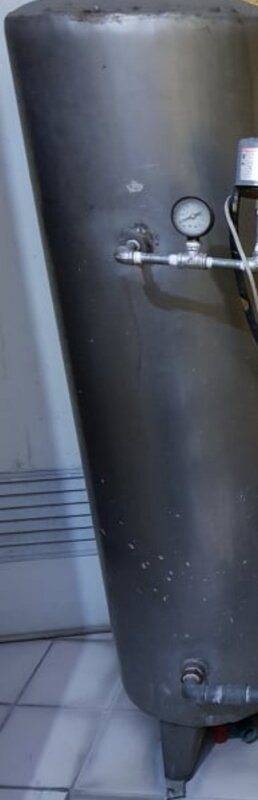

There is a lot of rusts in my water supply. I am suspecting the inside of my stainless steel pressure water tank is rusting.
But can the stainless steel pressure tank rust inside?
When i put magnet it doesn't stick to it.
I plan to replace it with very expensive Aquaflow pressure tank because I assume its so rusted inside. Been thinking for months.

You could disconnect the piping from the tank, shine a light into one opening, and look in the other opening. The pipes look like galvanized steel. I would look at the piping for the source of rust before looking at the stainless steel tank.
Likes russ_watters
Stainless steel is only stainless in the presence of oxygen. If the water contains sulphur or chlorine then the steel may be corroded, but the product is usually a black crumb.
Water flowing over stainless steel will deposit iron from the water in the surface that will give it a rust colour as the added iron oxidises.
Your tank is almost certainly OK. It is the pipes you must check.

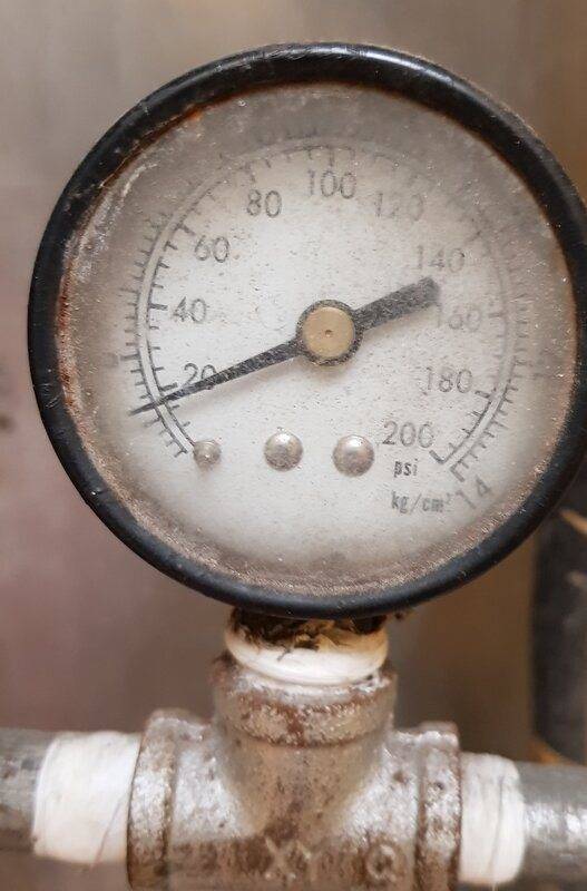

In your photo, there is a rust deposit around the pressure gauge, could be a leak there or within the gauge.

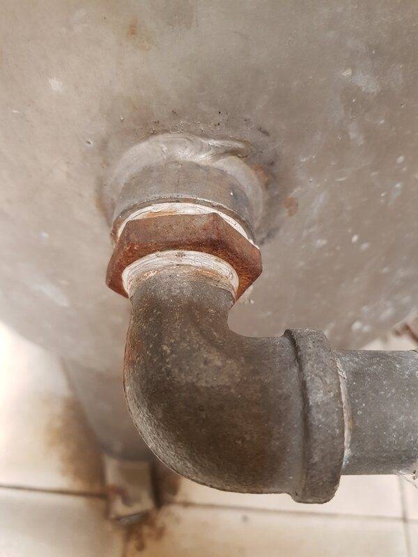

The plumbing at the bottom of the tank looks like there is an adapter or reducer there that shows as black in the photo, is that corroded or the wrong material?
Much cheaper to investigate those than replace the tank!

Keep in mind that pressure gauges fail. You don't know that zero on the gauge is really zero unless you physically remove the gauge and confirm that zero is zero. It could be pointing to 18 PSI at zero pressure, or it could point to 18 PSI at, say, 30 PSI.
There is bottom plug in the tank. When i open it.. the pressure further drops to zero psi. So it is under pressure. Last year i tried closing the inlet and outlet gate valves right after tank. Pressure continued to drop from 40 psi to 18psi. Tomorrow ill do it again to make sure pressure drops before i have the tank removed on saturday. Plumber charging expensive so thinking twice.
Last week after opening the bottom plug after 2 years of not opening it. Water couldn't flow out because so much rusts and sediment collected at bottom of tank and i had to insert wire to remove sediments. But after plug remained opened for 30 mins. All water came out with 18psi go down to 0 as water splashed out. So imagine how dirty inside tank.

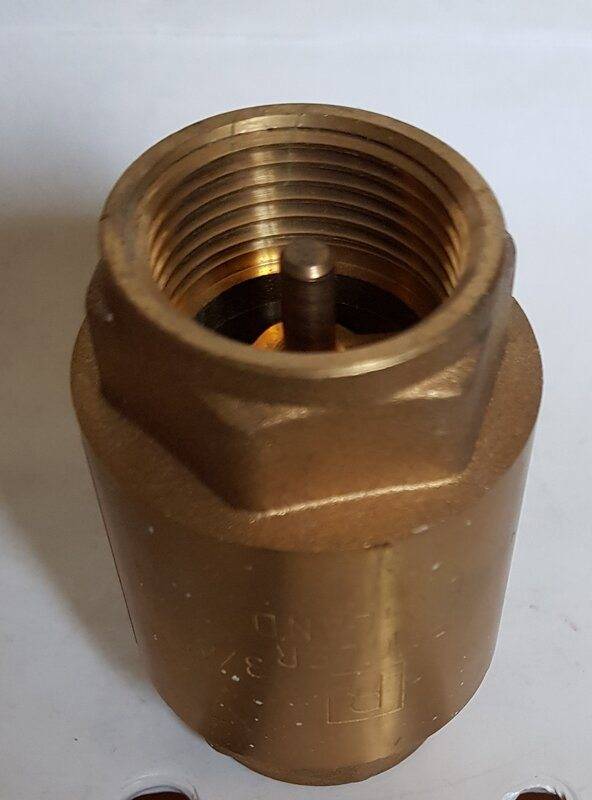

Ok. I turned on the power pump and closed the output gate valve of the pressure tank. Pressure still went down from 40 psi to 18 psi. When I tried to close the input gate valve of the pressure tank (located before the pump) with the tank output still closed. There was no decrease from 40 psi to 18 psi anymore. In other words, no leak anymore so water is returning to the souce.
So it's the lack of check valve causing pressure loss. Here is the weird thing. The house had no check valve for 8 years and pressure didn't go down but can be mainted at 40 psi. Say. If the water company has poorer pressure now, the water in the tank can go back to the source? But before even when it was 40 psi, the water didn't return even without check valve. So usually what must be pressure difference before water gets back to the source?

Anyway last year i bought a 3/4" check valve at a store but didnt put it since i couldn't find a cheaper plumber. What would theoretically happen if you put a 3/4" check valve in the water pump that has 1" piping? And where is the best place to put the 3/4"? Thanks!

A pump should have a NRV.

Ok you convinced me a check valve is required and my pump and pressure tank have hidden defective check valve somewhere. Tomorrow expensive plumber coming and we will be in full gear ppe to fix all of it. They will put bypass and adjustable with gate valve so i can divert water to pump or direct to house at will. Thanks for all the tips guys. After this weekend over. Id forget all about plumbing.
To be on topic for this subforum. There should be liquid material that can coat all rusty piping surface with plastic. Perhaps some nano tech material that can sense metal and bind to it as it flow then turn themselves to colored liquid as extra is flushed out of water system after procedure done. This is because its not possible to take apart all piping and replace them manually because it would mean taking apart many concrete in the house and bathrooms.
The "hidden" check valve would most likely be either in the pump or at the tank inlet. Maybe it is that Black fitting at the bottom of the tank.

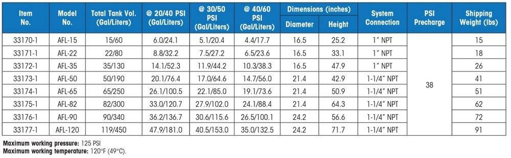

By the way. Last question. In diaphragm tank below. Does the 50 gallon version means it reaches 20.1 gallon at 20 or 40 psi? What does such spec usually mean?
If the pressure switch turns the pump on at 20 PSI, and off at 40 PSI, 20.1 gallons will flow into the tank. Then 20.1 gallons will flow out of the tank as you use water before the pump turns on.
So its the draw down value. I thought it was the level at 20 psi or 40 psi.
The store rep told me convensional pressure tank can only hold 1/4 the water. For my 42 gallon. Only about 10 gallon and draw down of about 4 gallon or is 10 gal or 1/4 the drawdown?
The diaphragm tank rep told me their diaphragm tank can hold 80%. So this is the maximum pressure volume before pump turns on? For the 50 gallon. The draw down is 20 gallon. So its less than half..better than the 12.5 gallon for conventional 50 gallon tank but i wonder if the price is worth 4 times.
