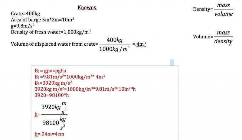

  1. A rectangular barge floats in freshwater. When a 400 kg block is loaded on the 5 m long by 2 m wide barge, the barge sinks a few centimeters deeper. How much deeper does the barge lower?
Archimedes' principle
This is where I am stuck. My textbook doesn't talk much about this at all.
You've done all the hard work. How much deeper does the barge have to "sink" to displace the extra 0.4 m3?
keithcuda said:
Yes, but you could have got there a bit faster from knowing the volume displaced and the area.
