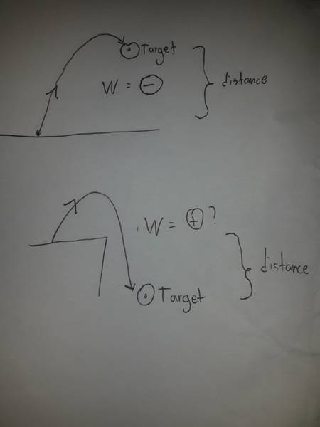

A bullet was shot at 40m/s
Elevation angle : 37°
Bullet mass = 0.01 Kg
Question : how much work is done by the force of gravity to the bullet since it was shot until it reaches the ground again
mgh = E.Pot
1/2mv ^2 = E kinetic
My teacher said, Work = F.S =0 joule, because gravity is only pulling downwards in this case, but S (distance) is in X axis, which means if we use horizontal Force, it will be zero, thus the work is Zero. If we use the vertical distance, it is zero. Thus the work is zero in both case (Work in X and Y axis)
Okay, i understand the logic in there. It suits the math
But my REAL question,
Certain amount energy was needed to shoot the bullet, correct? But somehow, the gravity make the suppossedly moving bullets back to stationary condition. Doesn't that require energy? To stop something moving? So how can the answer be 0 joule :/I have said this to my teacher but she doesn't seem to give a satisfying logical answer. Can you help me? .,.

Perhaps I can give you 'another' way to look at this:
Bullet goes in a projectile trajectory. In the absence of air resistance a parabolic trajectory. Let's look at that.
In the upgoing part gravity pulls down and the bullet goes up, so gravity is doing negative work: the bullet gains some potential energy.
In the downgoing part of the trajectory, the bullet loses that potential enrgy again, so gravity does positive work. Sum of up and down: zero.
Now about stopping a bullet, a most unhealthy activity.
As you say, when a bullet comes to a halt, its kinetic energy has to go somewhere. Ususally it is converted to heat by friction forces. A pile of sand is a good way to do that. Note that in you scenario the kinetic energy of the bullet at shooting time is equal to the kinetic energy at arrival. Exactly. (In other words: the 0 J of work from gravity is rather evident there !).
And note that gravity only affects the vertical component of the bullet velocity. But a scenario where the bullet is fired straight up proceeds the same way: without air resistance it comes down on you at the same speed it was launched. So no net work was done on it by gravity !
Finally, you can observe that things change when a projectile is launched from high up: if the target is much lower than the 'stopping place' some additional energy from work done by gravity makes its impact bigger than a projectile fired the other way, up. In the first case that work by gravity is equal the work done (potential energy provided) by the poor chap who dragged the projectile all the way up from the ground to the top of the castle tower.
Likes Hilmy atha

I see.. so is my drawing below correct?
Yes.
Likes Hilmy atha
