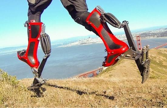

http://neurodope.com/wp-content/uploads/2014/11/bionic-boots3-550x358.jpg
