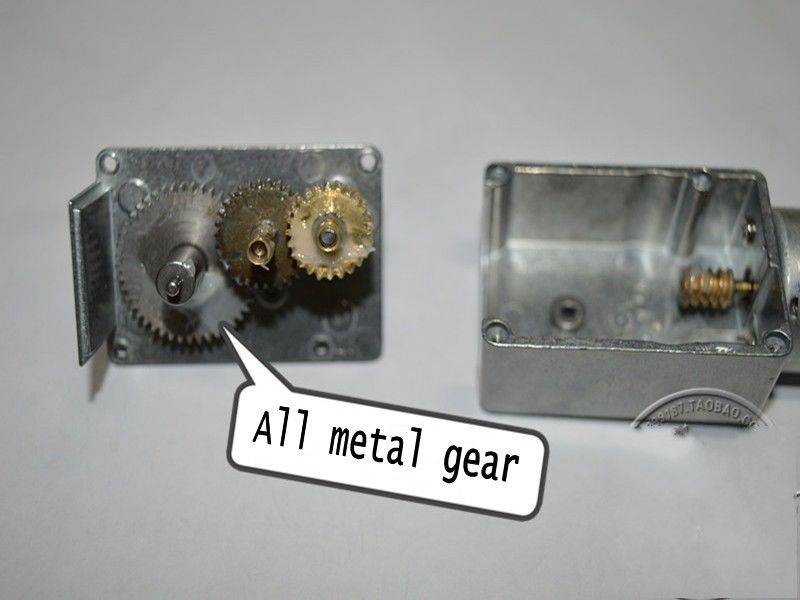

The motor itself has a built in gearbox with a worm gear (i will attach a picture). Could it be that they mean the dc motor's shaft's load torque by the 0.55 kg.cm without the gearbox? So with the gearbox it becomes much larger?

The motor you've shown is way undersized for the requirements you've stated, I recommend doing some more searching to find a motor/gearbox combination which provides the torque specification of 6 N-m.
You'll also need to consider expected power output and speed- you may be able to find a small motor with large reduction gearbox that meets the torque requirements, but would take minutes to move 90 degrees. You're going to need a motor with a combination of enough torque and reasonable speed/power output for your application.
