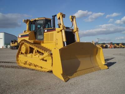

Attached image is of a Cat D8, weighing not quite 80,000 lbs.. so you'd need 5 of them to make 400,000 lbs... Just for an idea :)
