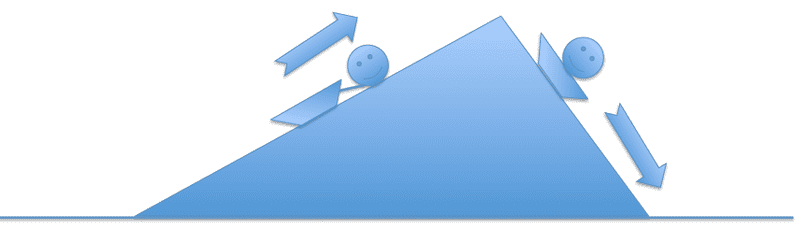

A child wants to go ride on her sleigh, and she decides to walk up the Big
Hill, of height 100 m relative to where she starts. There are two ways up;
the steep way, where the slope is 30.0 degrees, and the not-so steep way, where the
slope is 15.0 degrees. The coefficient of kinetic friction between snow and sleigh is
fs k = 0,100. The mass of the sleigh is 8.00 kg, the mass of the child is 30.0kg.
a) How much work does the child have to do on the sleigh to get it to the
top of the hill: the steep way? The not-so-steep way? How much potential
energy does the sleigh now have relative to the starting point?
b) The child now sits down on the sleigh and slides down the steep side.
What is her speed as she gets to the bottom of the hill? What if she would
have gone down the not-so-steep side?
c) Assuming that after reaching the bottom, she can continue on a horizontal
surface of snow, how far does she slide before coming to a halt (steep and
not-so-steep)?
a) In problem a i got
The amount of work done on the sleigh the steep way = 2425 J
The amount of work done on the sleigh the not steep way = 10813 J
Potential energy=7840 J
b) Speed down steep side= 40,3 m/s
Speed down not steep side= 35 m/s
c) I haven't solved c yet.
All answers are appreciated!
[/B]

The potential energy the sleigh gained is larger than the work the girl did on it - that can't be possible (in the steep way case).

This is the method that i used to calculate the work on steep way:
Fx= Fsin30-μn=0
Fy= n-mgcos30=0
n=mgcos30
Fsin30-μ(mgcos30)=0
F=μ(mgcos30)/sin30=14N
L= distance from standpoint till top
L= 100m/sin30=200m
W=F*rcosθ
W=14N*200m*cos30= 2425J
the same method used with the not steep way, but with different θ and L
for the potential energy:
U=mgy=8kg*9.80m/s^2*100m=7840J

If I don't misread your post, you placed the x-axis of the coordinate system parallel to the slope and y-axis perpendicular to it.
For ΣFx:
Ff = μ ⋅ N ... friction force
F ... girl's pulling force → why do you multiply it with the sine of the hill's angle?
plus: you forgot, that the weight has a component in x-direction to
ΣFy looks good to me

The length of the slope L is calculated correctly.
When calculating the work why do you multiply it with the cosine of θ? The girl is pulling the sleigh parallel to the slope, you already calculated the length L, which you need for the calculation of the work.
1) Think about the sum of the forces in x-direction again:
a) direction of the girl's pulling force (or at least the component that is able to do work)
b) the component of the weight in x-direction
2) To calculate the work multiply the pulling force with the length the sleigh is actually pulled (the whole slope)
That is correct and it must be less than the work of the girl, else you create a perpetuum mobile.

OK, doing it your way i get:
In the steep way
F=46N
W= 9200 J
The not steep way:
F=27.86 N
W=10755.61 J
In the steep way
F=46N
W= 9200 J
The not steep way:
F=27.86 N
W=10755.61 J
Looks right.
